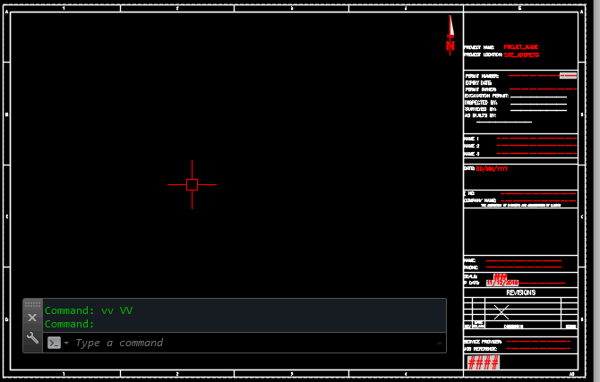

Hello @Tharwat
I have used this Routine for a year...but now i got an error when running to New Template..
I found the issue...If i run the script on  *.dwt file (Directly opens in AutoCAD) this Script updates the attributes in all the Layouts. (12 Layouts).
If i insert the Template/Layout on another *.dwg file , the script is not update anything.
While inserting the Layouts the Handle name of the Attributes getting changed.
Can you help me to solve this Issue.
