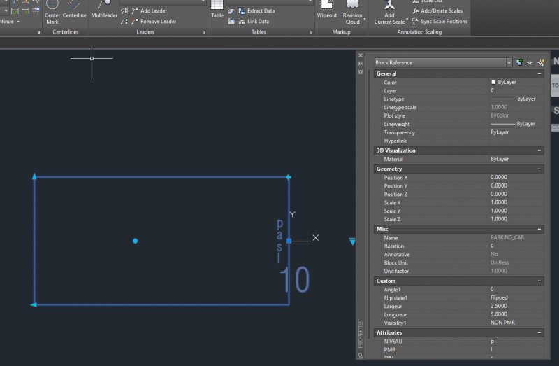

Hi everyone.
I'm try to make a selection with a (ssget "x" '((2 "parking"))) but the block named "parking" it's a dinamic block. I have been discover that dinamic blocks behave like a AEC Object renamed his name with a alphanumeric code.
Like you can see the name of the block is "parking_car", but when you make a "entsel" give this result: "((-1 . ) (0 . "INSERT") (5 . "3326") (102 . "{ACAD_XDICTIONARY") (360 . ) (102 . "}") (330 . ) (100 . "AcDbEntity") (67 . 0) (410 . "Model") (8 . "0") (100 . "AcDbBlockReference") (66 . 1) (2 . "*U72") (10 0.0 0.0 0.0) (41 . 1.0) (42 . 1.0) (43 . 1.0) (50 . 0.0) (70 . 0) (71 . 0) (44 . 0.0) (45 . 0.0) (210 0.0 0.0 1.0))"

You're missing a point in your code it should read
 (ssget "x" '((2 [color=red].[/color] "parking")))
but IMHO you should be looking for blocks
 (ssget "x" '((0 . "INSERT")))
then loop through the blocks checking if the blocks effectivename property = "parking"
Cut and paste the following to the command line and press enter.
(vlax-dump-object (vlax-ename->vla-object (car (entsel "\nSelect Entity : "))) T)
This should give you a list of properties for the object. If it is an anonymous block (*U..) one of the properties near the top of the list will be "EffectiveName"
This is the name of the block entity on which it is based.
Look here for code to access this using autolisp and visual lisp =>http://www.lee-mac.com/effectivename.html

Hi dlanorh. thanks for your answer.
You are right. I missing a point in a text, but no in my code ;). I want to select all blocks with the "Effectivename" Parking-car on my draw.
I try to see the page that you give me, but the link are broken.
Since you want to select on screen like with using QSELECT command, this snippet would do it in active layout block space (Model Space) - it won't search nesting of blocks since you can't visually select them - you can only retrieve their enames by using (tblobjname) function in combination with (entnext) and query INSERT entities...

Hi,
To reduce the quantity of selecting the target block name but this still requires iteration over selected blocks.
(ssget  (list '(0 . "INSERT") (cons 2 (strcat "`*U*," "parking"))))
