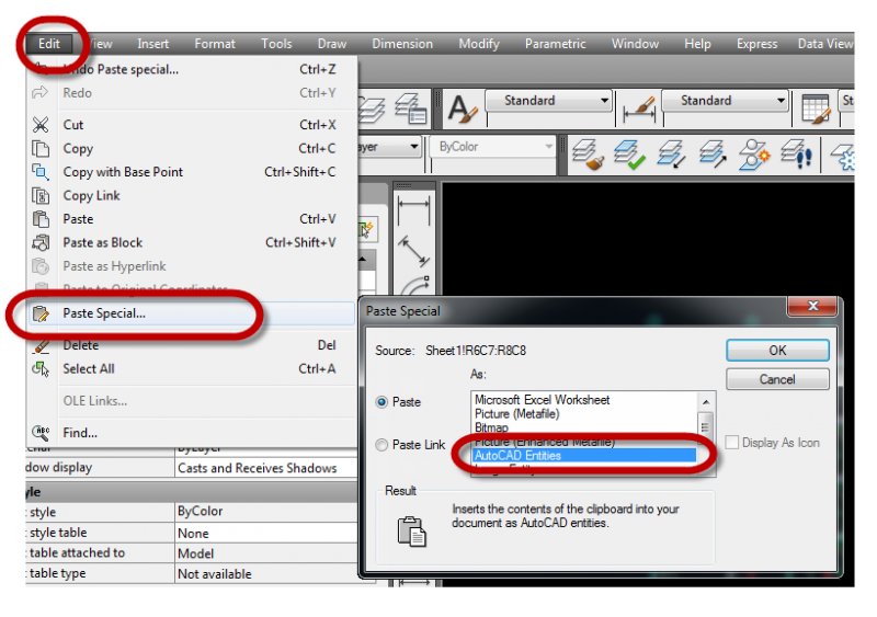

Why not copy and paste as an AutoCAD table
- Select Range in Excel
-In Autocad Go to Edit Paste Special
[ATTACH]63933[/ATTACH]
Thanks for your approach, but I do not want to manually copy and past in autocad.

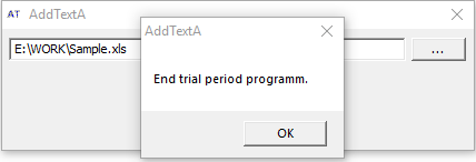

I don't understand this, is it a trial program? When I clicked on the start it says "end trial period program!" and it does not work. Sorry man I'm here for the lisp not for buying a third party app, rather I would be interested in lisp coding and understanding how this language works. I'm proficient in VBA-Excel but not in lisp I'm here to learn lisp.
