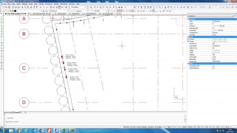

However, I am facing a small problem. I have to measure the difference between the actual position position of a slanted concrete wall in comparison to the design position. To do this, I overlay the points given to me by the engineers onto drawings provided to me by design engineers;
I can do this via the Aligned Dimension tool, however this is a really pain staking, eye tearing activity, especially if you have 100s of points! I would appreciate if anyone out there could assist me!

I need to create an as-built drawing of a liner wall. This liner wall is slanted (as shown on screenshot attached), and so, rotating the drawing is not a feasible option. The engineers are not at fault lol, its just that the liner wall is just a bit awkward. I could just do each point individually in order to determine the actual position of the liner wall compared to design, but this will take me ages, and so, I really hope there is a quicker solution out there!

Below is a short routine to find the shortest distance between a point and a line.
The osnap settings dialog will popup first to allow setting of the relevant osnap mode for the points. You will then be asked to select a line. This can be a polyline.
The lisp will then repeatedly ask for a point and display the shortest distance to the line.
To exit and rerun press ESC
It seems that the engineers could be giving you a much easier time. The construction was presumably designed on a coordinated layout, and built to this coordinate system. Why are your engineers not giving you measurements in the same coordinate system? Then the comparison is just a matter of inserting the as-built drawing into the design drawing, without any of your "really painstaking, eye tearing activity" trying to align them. The alignment is done automatically by the coordinates. You must educate the engineers!!
I am afraid my eyesight isn't that sharp to see the details. It looks to me to be almost a contiguous piled wall, with an internal wall.
If you plot the as-built points, then you take the distance perpendicular to the theoretical line. There is no aligning to be done as the coordinate system is the same for both cases.
LOL your eyesight is okey. The quality of image is too bad
