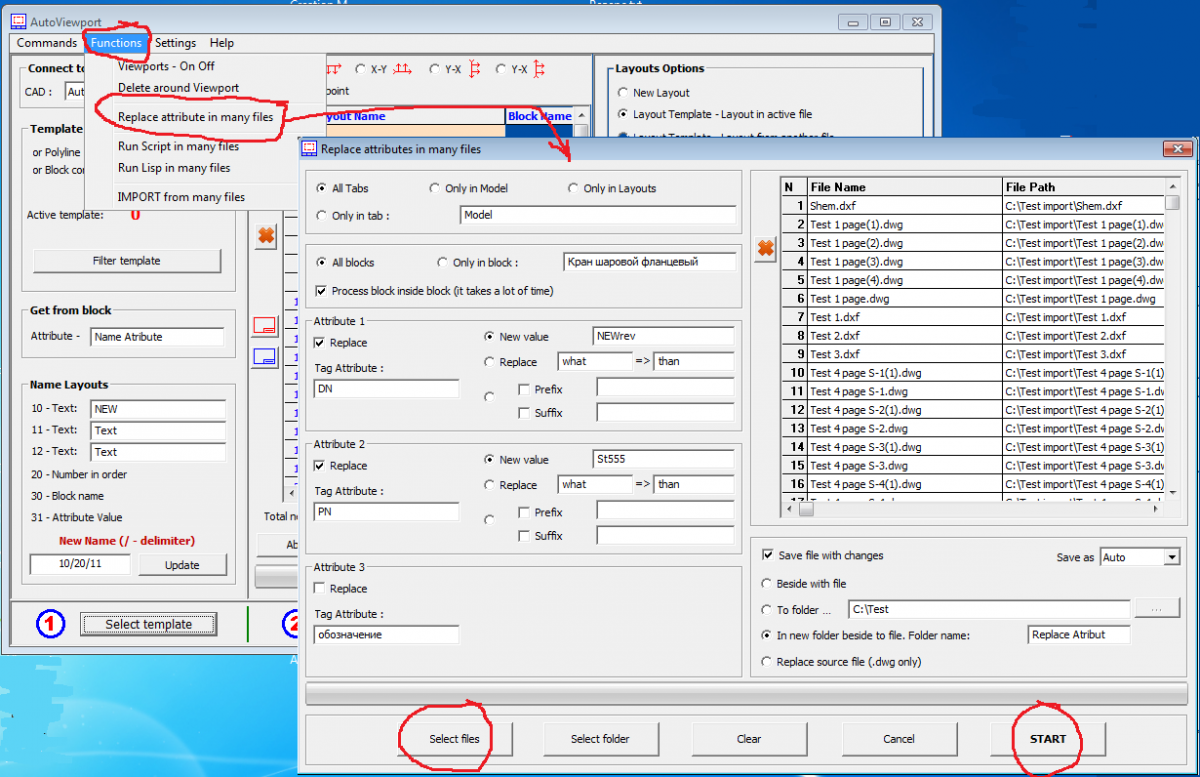

maratovich Posted March 30, 2019 Share Posted March 30, 2019 I do not insist, it is only for possible options ... (if I interfered with the topic - I can delete this message) If there is no ready solution yet... Maybe this will help you: Quote Link to comment Share on other sites More sharing options...
