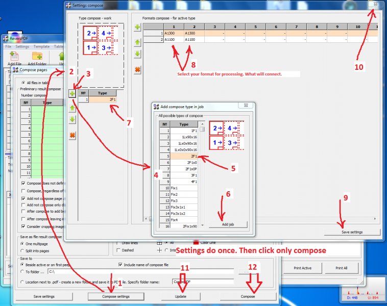

How to print drawings one above the other on a plotter ?
If you print to the plotter, then there is an empty space on top.
I have a wide roll of paper.
How to print the drawings one above the other?
AutoCAD can not connect different drawings when printing.
Do you have two options
1. You can create two title blocks next to each other.
Then you can select two drawings for printing at once.
2. Print your drawings in PDF.
Then merge the drawings into one large PDF page.
And then print a large PDF on the plotter.
This is compose pages.
Try using this:
https://www.kdmsoft.net/reverspdf.html

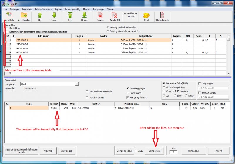

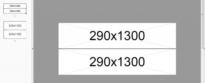

How to connect the two one to the other?
290x1300 and 290x1300
420х1100 and 420х1100

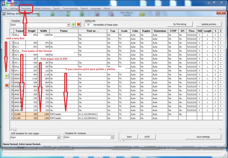

You need to perform the program settings once.
Then you will automatically compose pages.
In the archive, an example of PDF files and an example of the program settings.
Do as specified in the example.
Sample.zip
