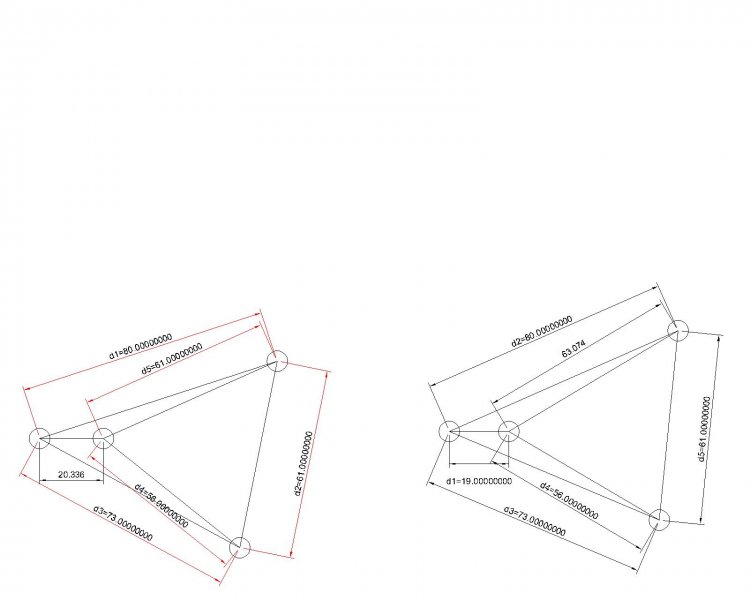

Hello, I've decided to start working a little with AutoCAD to make a bracket that I need cut out. The bracket will have 4 bolt holes that are 6.7mm in diameter each. I am having trouble getting my bolt hole center distances the exact distance I need.
Here's a rough image with some measurements.
I have got the red (19mm) circles perfect since they didn't have any angles to worry about.
I am currently trying to do the top right side circle, but I guess I'm just too unfamiliar with AutoCAD (I've been watching a few videos on it) because I cannot get the distance from orange and blue to be 80mm and 61mm exactly..... I hope you guys can understand what I'm having issues with, I think I explained that pretty badly.....I need the distance from the left two circles to be exact to the top right circle. I don't know how to make it an exact distance. I've tried drawing lines from the left two circles the distance I need, but I don't know the angles so that never worked. The closest I got was like orange 79.xxx mm and blue 60.xxx mm.
I'll be needing to do the same concept to get the distance from the top 3 holes to the bottom one after I figure out how to do it. Can anyone help? Thanks.

Draw a circle, using the left most circle as the center point, and use 80mm as the radius.
Draw a circle, using the other circle as the center point, and use 61mm as the radius.
Where they intersect, is the center of the upper-right circle.
Repeat for the lower right circle.
Erase the construction circles.

I'm not sure that worked? I got it very close doing some triangle math yesterday. I just reconstructed what you said to do on my "completed" version and this is what I end up with:
80-19=61, which means the intersection will be in a straight line from those 2 holes. One of those numbers is wrong.
I drew the lower hole and worked back to the upper hole, the 61mm blue line should be 63.

Using parametric constraints I get a length of 20.336 for the horizontal line, or if the horizontal line is held at 19.0 then I get 63.074 on the inside upper diagonal.
I agree with SLW210. 80mm-61mm=19mm Hence a straight line. I think you should be measuring to a higher precision for example XX.XXmm. I work with diagonals all the time and can often be a couple millimeters out over 5,000mm or more. An accuracy of 2/5,000 and this is acceptable for our site measures. As you are only working to 10’s of millimeters. A couple of decimal places will certainly help you. Notice Rkent's dimensions are to three decimal places. I know this may be difficult to measure but try. I would also check the angles using the “cosine rule” and or the “law of sines”. Remember the angles of a triangle must add up to 180°. Failing measuring Bigal and Remark have good real world solutions. May be a silly question but can you not just give the bracket to the steel fabricator and ask them to replicate it?
