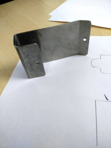

mavensharma Posted April 21, 2018 Posted April 21, 2018 Is it sheet metal part in solidworks or what do you call or name this part and how do i design this part,i mean under sheet metal or something else? Quote

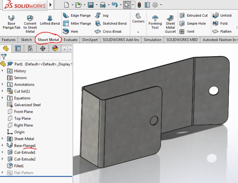

JD Mather Posted April 24, 2018 Posted April 24, 2018 I would use the Sheet Metal tools. But there is no logical reason that the standard tools could not be used. To get a Flat Pattern though - you need to create as, or convert to a sheet metal part. 1 Quote
