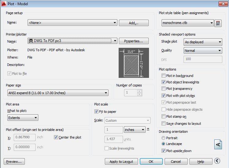

I have a nice utility to plot to .pdf (courtesy of BrianTFC) which works fine in the model plots.
(defun c:Test()       (vl-load-com)            (if (setq filename (getfiled "Save File Location" ""  "pdf" 1))   (progn        (command "-plot" "yes" "" "DWG To PDF.pc3" "ANSI expand B (11.00 x 17.00 Inches)"           "inches" "landscape" "yes" "Extents"           "fit" "center" "yes" "monochrome.ctb" "yes" "a" filename "no" "yes")                 )           )       )

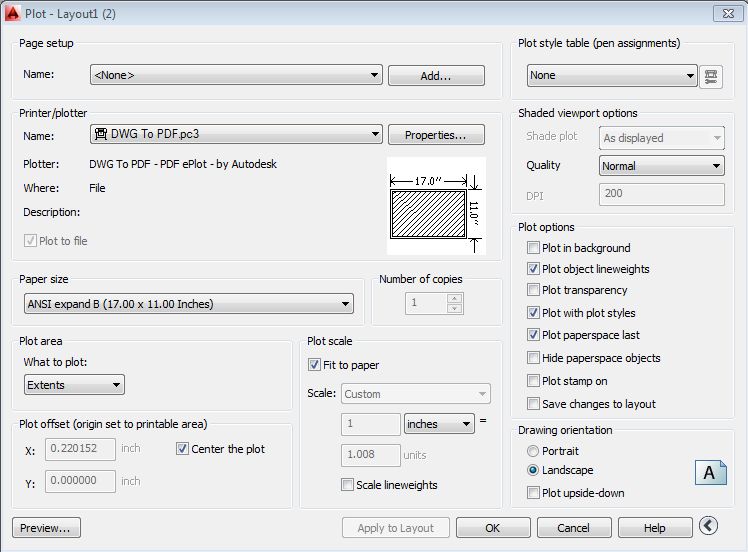

However, in Layout it does not work, and gives a few clues on what is going on.
Unknown command "MODELS\LYONDELL\2018-071\MODELS\PIPING\PIPE TEST 2.PDF". Press F1 for help.
Unknown command "NO". Press F1 for help.
Unknown command "YES". Press F1 for help.
One, what does the code need to work.
Two, so how can you know what the order is? Can you prompt the system to give you hints?
Here is the plot dialog for model:
Here is the plot dialog for layout:
Greg

Give this a try.
;;; PDF's All Tabs to a folder of your chose.
(defun c:pdflay ( / *error* cm fd )
(chcolor)
   (defun *error* ( msg )
       (if (= 'int (type cm))
           (setvar 'cmdecho cm)
       (if (= 'int (type fd))
           (setvar 'filedia fd)
       (if (not (wcmatch (strcase msg) "*BREAK,*CANCEL*,*EXIT*"))
  (if (not (setq folder (getfolder "Select folder to save PDF'S")))
   (setq folder (getvar 'dwgprefix))(setq folder (strcat folder "\\")))
   (foreach layoutname (vl-remove "Model" (layoutlist))
     (command "._layout" "set" layoutname)
           (setq fd (getvar 'filedia)
                 cm (getvar 'cmdecho)
           (setvar 'filedia 0)
           (setvar 'cmdecho 0)
 (command
 "-plot"
               "_Y" ;; Detailed plot configuration? [Yes/No]:
               ""   ;; Enter a layout name <Current-Layout>:
               "dwg to PDF" ;; Enter an output device name:
               "ANSI expand B (11.00 x 17.00 Inches)" ;; Enter paper size:
               "_I" ;; Enter paper units [inches/Millimeters]:
               "_L" ;; Enter drawing orientation [Portrait/Landscape]:
               "_N" ;; Plot upside down? [Yes/No]:
               "_E" ;; Enter plot area [Display/Extents/Layout/View/Window]:
               "_F" ;; Enter plot scale (Plotted Inches=Drawing Units) or [Fit] <1=1>:
               "_C" ;; Enter plot offset (x,y) or [Center]:
               "_Y" ;; Plot with plot styles? [Yes/No]:
               ctb ;; Enter plot style table name (enter . for none):
               "_Y" ;; Plot with lineweights? [Yes/No]:
               "_N" ;; Scale lineweights with plot scale? [Yes/No]:
               "_N" ;; Plot paper space first? [Yes/No]:
               "_N" ;; Hide paperspace objects? [Yes/No]:
               (strcat folder (cadr (fnsplitl (getvar 'dwgname))) "-" (getvar 'ctab) ".pdf")
               "_N" ;; Save changes to page setup [Yes/No]:
               "_Y" ;; Proceed with plot [Yes/No]:
       (princ "\nCommand not available in Modelspace.")
(defun chcolor ()
(initget "Black Color")
(setq pp (getkword "\nChoose Color [black/Color] <Black>: "))
(if (= pp "Black") (setq ctb "monochrome.ctb"))
(if (= pp "Color") (setq ctb "acad.ctb"))
(if (= pp nil) (setq ctb "monochrome.ctb"))
)(princ)

Brian
