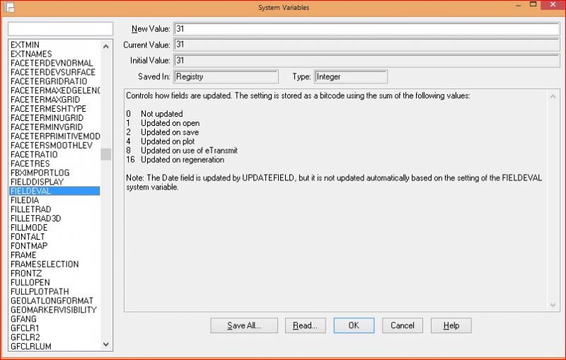

erratic Posted April 10, 2018 Posted April 10, 2018 Hopefully I am just unaware of a setting or method for doing this but so far the field command is handy but missing something. Associative updates. When a polyline is drawn and used for calculating the area the field command does a quick job of extracting that info into a field text element. Problem is when that polyline boundary is changed the "field text" that was established previously does not update. Is this even possible or am I S.O.L.? Quote
Dadgad Posted April 11, 2018 Posted April 11, 2018 (edited) When in doubt? Check Lee Mac out. http://www.lee-mac.com/areastofield.html Thanks Lee! This is one of a number of lisps dealing with FIELDS on Lee's site. Check them out, you'll be glad you did. Aside from Lee's BIG magic, you should probably consider what may or may not, be available options in MEP, which I do not use. I use 2013 Vanilla, but it is highly likely that the variable FIELDEVAL is in your software too. Worth a shot. The following lisps looks pretty cool too. http://www.lee-mac.com/fieldobjects.html http://www.lee-mac.com/arealabel.html Lee Mac rocks! Edited April 11, 2018 by Dadgad Quote
SLW210 Posted April 11, 2018 Posted April 11, 2018 Unless you changed the Sysvar FIELDEVAL value, a regen, save, etc. should update the FIELD as shown by Dadgad. If that doesn't work, post the .dwg. Quote
erratic Posted May 10, 2018 Author Posted May 10, 2018 Well that was easy. Thanks for the input. FIEDLEVAL was all I needed. Apparently I did a poor job investigating this initially. Thanks again! Quote
Dadgad Posted May 11, 2018 Posted May 11, 2018 Glad that helped you. When in doubt try looking through your SYSVDLG box, choose a name which likely puts you in the right zipcode, like FIELD, not FIEDL, then just scroll through the list with your keyboard cursor, and you will certainly learn a lot, and probably find what you are looking for. Quote
