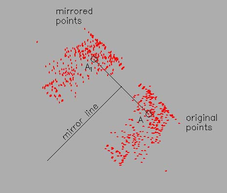

AHA I think I know what my problem is... I have entered the coordinates in back to front... any easy was to go from lat long to long lat without re-entering everything?
I think it takes a mirror of the object(s) about a vertical axis. Then maybe a rotate after that, I don't recall offhand. Then a move to get a known point back on correct coordinates.
To get the coordinates mirrored, this is a way I have just tried.
First choose one point (A) and draw a line from this point to its mirrored coordinates (A1) this should be a line at 45°. Now draw a line from the midpoint at right angles. This is your mirror line. Set MIRRTEXT to 0 so that all text keeps the right way round, and mirror all your points using the mirror line. (Just check a few coordinates to make sure) :D
