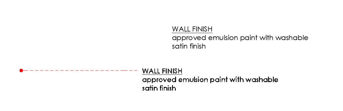

3dwannab Posted July 4 Author Share Posted July 4 This has raised it's ugly head again, this time with Mleaders. The normal seems to be fine. See attached and the screenshot below is of Mtext (top entity) and the Mleader (btm one) normal issue mleader.dwg Quote Link to comment Share on other sites More sharing options...
