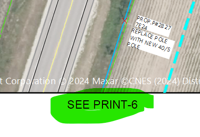

no. I was asking Matchline page no. mtext to be hyperlinked through lisp, page no. should connect with layout number.
_hyperlink -->view of this drawing--> select layout same matchline number.

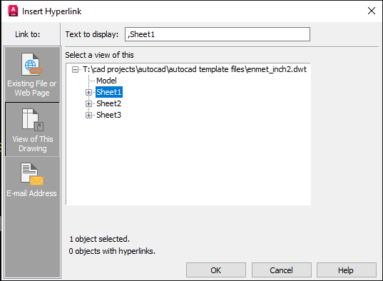

@smitaranjan Here is a simple example to add a hyperlink for each layout:
(defun c:foo (/ e)
   (vl-load-com)
   (foreach n (layoutlist) ;; for each layout name,
      (if (setq e (entsel (strcat "\nSelect Object to link to \"" n "\""))) ;; select an object to add the link
         (vla-add
            (vla-get-hyperlinks (vlax-ename->vla-object (car e)))
            ""                  ;; External Hyperlink
            (strcat "Go to " n) ;; display description
            (strcat "," n)      ;; Named location in the document
  • Thanks 1

I'm not exactly sure what you mean. If you mean that you just want to enter a number, like 1,2,3, etc., then your sheet naming for the layouts much be consistent. The reference for the hyperlink is entirely based on the sheet tab name. So if all your sheets are named for example "page 1", "page 2", "page 3", etc. then you can determine the correct layout from the name.
BTW - the HYPERLINK command can do this without the need for an AutoLISP routine if you are just doing a random layout, presenting all the layout names is a list, and even named views within each layout.
If you look at this image its a make layouts walking along a line or pline. It auto rotates the viewport to suit, I could add the what is previous page and what is next page, I am getting confused as to why you want to use hyperlinks. For a single road style plan then the before after is relatively easy, when we get to grid layouts a sheet can have say 4 sheets touching. You can get all layout names and there corresponding TABORDER. So labelling multiple layouts could be done.
