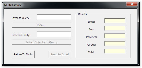

BIGAL Posted April 6, 2018 Posted April 6, 2018 Here is count blocks, custom version of dataextraction with lots of ifs and butts borders on a commercial request not expensive but just how long will the rubber band stretch after version 5 if repeated changes. As I already suggested its all out there just a case of putting together a number of seperate routines with a suitable front end. See image above. (defun blockcnt ( / ss effname) (if (and (setq obj (vlax-ename->vla-object (car (entsel "\nPick block ")))) (= (vla-get-objectname obj) "AcDbBlockReference") ) (progn (setq effname (vla-get-effectiveName obj)) (setq ss (ssget "X" (list (cons 0 "INSERT")(cons 2 effname)))) (alert (strcat "There is " (rtos (sslength ss) 2 0) " " effname " blocks)) ) (alert "you did not pick a block") ) (princ) ) (blockcnt) Ps working on a global blocks attributes to table no hard coded block names. Yes my friend paypal is involved. Quote
