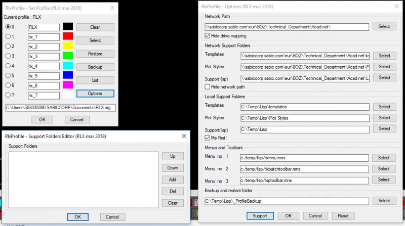

rlx Posted March 29, 2018 Author Share Posted March 29, 2018 Is (action_image "key1" "(setq val1 $value)") a undocumented ? need to make some dcl also : image { rather than icon_image need to make some dcl code for testing There seems to be a few ways to do images and what is returned. action_image doesn't turn blue in vlisp editor , neither as a lisp or DCL command .. pitty just wanted to hide the button for the support folders editor. No big deal though. Just had the idea for a hidden button and wondered if it was possible. IT department constantly sabotages my settings so I decided to fight back with a little tool to (re)set my environment with one click. gr. Rlx Quote Link to comment Share on other sites More sharing options...

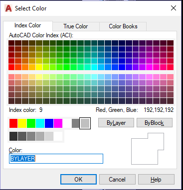

rlx Posted March 29, 2018 Author Share Posted March 29, 2018 Wow nice finding Roy, Looks like this is the answer for Rlx's interesting question! The first thing I did was to look for the mnemonic(s) in Lee's code, but then remembered about this approach aswell. And this also answers my old unasked question "can you use grread while dialog (DCL) is opened?", I tested that question by myself a time ago and it didn't worked. But the technique demonstrated here provides alternative: by assigning actions to say 30 invisible buttons and work out their actions. ...and I still think that Lee is an alien whose codes need to be explored by us. Once came to the same conclusion that Lee is out of this world If you look at the color dialog you see some sort of grread in action , just look at the middle bar with the standard colors and hover over it. You see no borders until you go over them. This functionality is probably not exposed to us mortels...only .net etc. happy coding gr. Rlx Quote Link to comment Share on other sites More sharing options...
Grrr Posted March 29, 2018 Share Posted March 29, 2018 If you look at the color dialog you see some sort of grread in action , just look at the middle bar with the standard colors and hover over it. You see no borders until you go over them. This functionality is probably not exposed to us mortels...only .net etc. Rlx, do you mean the truecolor dialog? Quote Link to comment Share on other sites More sharing options...
rlx Posted March 29, 2018 Author Share Posted March 29, 2018 Rlx, do you mean the truecolorjust the standard one , but in fact now I think about it , tooltips pretty much do the same Quote Link to comment Share on other sites More sharing options...
