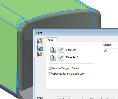

dusko Posted March 27, 2018 Posted March 27, 2018 Hello people! I have problem with fillet as you can see it on picture. Can't figure problem out. Do you have any idea why this is happening, since this is tenth (similar) part i have done. File is over 500KB so i can't upload it. Thank you! Quote
Lazer Posted March 28, 2018 Posted March 28, 2018 Difficult to see what is going on there without the model being posted. Did you try rolling the end of part icon above the first sweep before saving to reduce the file size? Quote
dusko Posted March 29, 2018 Author Posted March 29, 2018 No i didn't! I'm in learning process so thank you for advice. I am starting to "feel" how Inventor work but have stuck on this fillet. RASKOLJEN PROFIL 20X20_horizontalni_ZAVRSNI_LEVO_sredina_cadtutor.ipt Quote
JD Mather Posted April 9, 2018 Posted April 9, 2018 Have you installed all Service Packs and Updates for your version of Inventor? I think I would remodel from scratch as your technique could be significantly simplified. Often a Face Fillet will work where Edge Fillet fails. Quote
