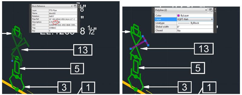

My goal is to have a the program explode attributed blocks with the Description attribute that has the string "VV??", "VB??", "VY??", "VD??", "VG??", "VT??", "VN??", "VP??", "V3??", "V4??". The question marks are any non-blank character.
The pic below on the left shows the “before” block, and the after shows the former block after it has been exploded and a portion of the entities set to another layer. I have to change the graphic manually since I do not think it is possible to come up with an automated solution. But I would like a prompt for the user to be able to pick the lines to be changed to a certain layer (in this case "FTG-Hndwhl", then go on to the next block that meets the criteria.
Here is the code so far (adapted from prior ronjonp code):

ronjonp, thanks for that (dirty or not)!
That worked pretty well, but it changed the entire block to the new layer instead of leaving it at its native layer. Only some of the polylines from the block need to go to the new layer and have the user manually pick them.
But I thought about it some more and I had another idea. After the block is exploded, can a collection be made of the “just exploded block”, whereby the user can cycle through the polylines and be prompted to change a highlighted polyline to the new layer? That might be a better solution than manually picking. I don’t know if that is possible though.
Greg
Any thoughts?
Greg

I appreciate the help!
The Backstory: The client wants the symbology on different layers, so that's where this is coming from. The symbols are generated by blocks when the .dwg is created, with the granularity on the levels required by the client exceeds the capability of the program generating the data. So I am having to put together a procedure that will turn a drawing with exactly the same graphical content into one whereby it will meed the client's CAD standards.
I hope that makes some kind of sense.
Greg

ronjonp, it cycles through all of the elements like it is supposed to so that part is great.
But it turns everything red, whether I hit return or do a pick. So, am I doing something wrong?
Greg

 ;; RJP - Simple get attribute value sub .. no error checking
 (defun _getattvalue (block tag)
   (vl-some
     '(lambda (att)
 (cond ((eq (strcase tag) (strcase (vla-get-tagstring att))) (vla-get-textstring att)))
     (vlax-invoke block 'getattributes)
 ;; RJP - added (66 . 1) to filter ( attributed blocks )
 (cond
   ((setq s (ssget "_C" '(7.244 2.071) '(16.665 10.003) '((0 . "INSERT") (66 . 1))))
    (setq blks (vla-get-blocks (vla-get-activedocument (vlax-get-acad-object))))
    (foreach en (vl-remove-if 'listp (mapcar 'cadr (ssnamex s)))
      (if (and	;; If we have a value, and it does not match the filter then remove item from selection
	(setq v (_getattvalue (setq o (vlax-ename->vla-object en)) "Description"))
	;; vl-string-search example ( more legible IMO )
	(vl-some '(lambda (x) (wcmatch (strcase v) (strcat "*" x "*")))
		 '("VV" "VB" "VY" "VD" "VG" "VT" "VN" "VP" "V3" "V4")
   (vlax-for i (vla-item blks (vla-get-name o))
     (if (vlax-property-available-p i 'length)
       (progn (setq d (vla-get-length i))
	      (if (or (equal d 0.234409 1e-4) (equal d 0.146518 1e-4))
		(entmod (append (entget (vlax-vla-object->ename i)) '((8 . "NewLayer"))))
   (vla-update o)
    ;; Highlight selection
    ;; (sssetfirst nil s)
(vl-load-com)
