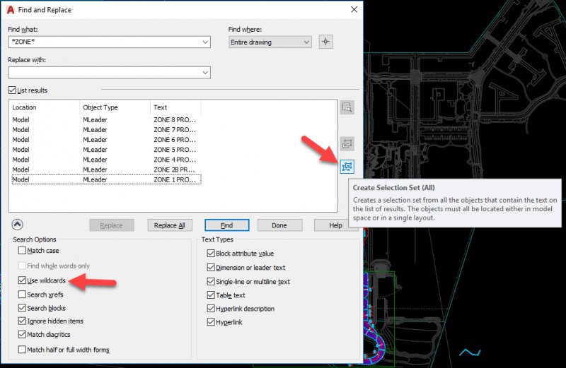

BTW .. you don't need code to do this. The FIND command will create a selection set of items based on a common text value.
Yes. More information is always better. This thread is about 2 pages longer than it needs to be just because your question eluded to something different.

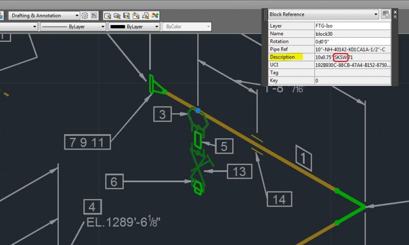

Just so that any further ambiguity can be minimized I am including a test drawing and a screen shot. The test drawing is not a native AutoCAD document so it is going to bark at you and make you aware of that (I am working on another program to address that issue). In the screen shot below, you can information on the block (from the drawing, the number 3 in the square) and the string "10x0.75" SKSW 71" is found in the "Description" attribute. Because that has "SKSW" in the description, I want to keep it in the selection.

In this drawing there are 27 blocks on the "FTG-Iso" layer. On the "Description" attribute, there is a string of information present. I want to find any of the following strings in the description:
SKSW
NISC
NIPL
THSC
WTBW
NRSC
PL
KASC
KASW
Those Descriptions that do not have those sequence of characters should be omitted from the selection.
And if they appear keep it in the selection and change the layer to "FTG-Pipe".
In this sample file there are 6 blocks of the 27 that meet this criteria.
I hope that clears up what the objective is and I now wish I had put this information earlier in my post. Please let me know if anything is unclear. Hopefully at the end of the day I will have the problem solved with your help.
