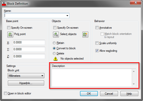

Block description is part of the block definition. Try creating a new block and look at the lower right corner of the options.

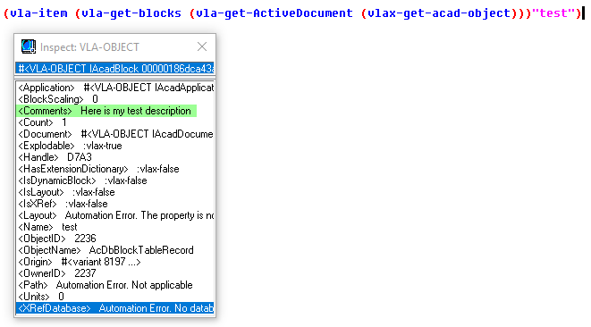

Not sure what an equivalent in VL is it may be a property rather than a get.
Here's a VL example:

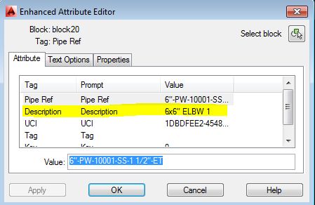

This is what I mean by description. I want to be able to pull the description value out and examine it to decide whether or not to include it in the selection or not.
Hope that makes sense.
Greg

A block description typically refers to this:
  Lee Mac said:
:facepalm: There was no mention of attributes in your first post...
[ATTACH]63539[/ATTACH]
I thought the same thing too. :facepalm: Sometimes I wish there was a requirement to post a sample dwg....
3rd agree what confused me, I do admit probably have never added a description to a block, just named it appropriately.

Ugh! Sorry guys for making things so confusing. It was seen in the QPROP window so I assumed (wrongly, of course) that it was the natural description. I should have investigated further and have made it clear that it was a attribute called "Description".
On the bright side, I'm still learning and I will not give up. You guys are the best. :)
