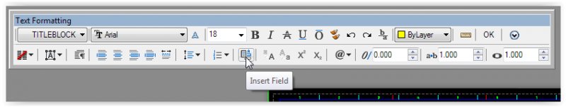

-How can i add this inside an existing mtext? Lets say i have an mtext sentence, in which i write "The surface of the hereby plost eaquals to [here goes field reference] sq.m."
Inside mtext are fields so you pick an object like a pline then drill down a level to area and save.
Yes this worked, but i still need to regen each time i change the polyline shape. Is there a way for changes to happen automatically and the fields to be updated in case i forget to regen
You would need some form of reactor not my area of expertise. Some one else may suggest something, in mean time RE or make a key do RE like on F12 or an icon on a toolbar.
