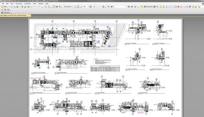

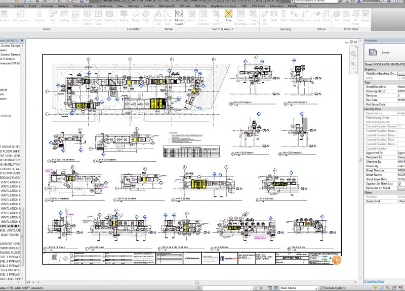

Cheap Belt Posted March 15, 2018 Posted March 15, 2018 I'm iusing a fill pattern for my mechanical equipment via filter, it displays correctly but doesn't print. I have tried changing several settings but nothing I do will make it print on the PDF aside from changing the model style from hidden to wireframe. This then displays the drawing incorrectly and makes it less clear. See attached screenshot for further details of this problem, would love to know how to fix it. Quote
tzframpton Posted March 18, 2018 Posted March 18, 2018 Can you post a screen shot of your print settings? I have been doing this for years with no issue. Quote
Cheap Belt Posted March 18, 2018 Author Posted March 18, 2018 Interestingly, when I add a view to the sheet that has a shaded view style - it prints the filters in the plan/section views. I think some graphical error may be happening behind the scenes somewhere Quote
BowkerCAD Posted August 7, 2019 Posted August 7, 2019 I know this is an older thread now, but you just have to print using raster processing and not vector. Located in print settings dialog box. Quote
