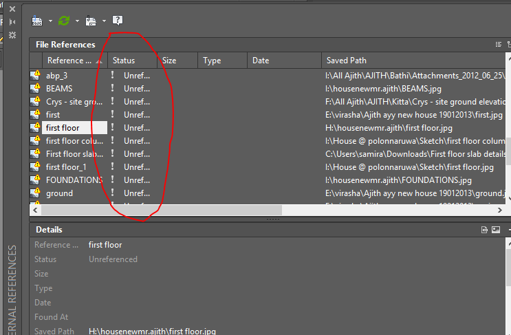

wimal Posted March 9, 2018 Share Posted March 9, 2018 How can remove this unreferenced files from the external reference dialog box. Quote Link to comment Share on other sites More sharing options...
SLW210 Posted March 9, 2018 Share Posted March 9, 2018 Try -PURGE or WBLOCK. Quote Link to comment Share on other sites More sharing options...
rkmcswain Posted March 9, 2018 Share Posted March 9, 2018 There are several suggestions here. You might also switch to the TREE listing of the xrefs to see if any of those are nested. Quote Link to comment Share on other sites More sharing options...

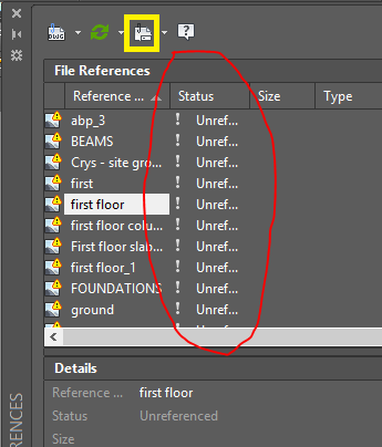

Dana W Posted March 9, 2018 Share Posted March 9, 2018 Select the top one, shift select the bottom one to select the rest, right click inside the selected list, click detach, wait about 3 seconds, done. Quote Link to comment Share on other sites More sharing options...
SLW210 Posted March 12, 2018 Share Posted March 12, 2018 Select the top one, shift select the bottom one to select the rest, right click inside the selected list, click detach, wait about 3 seconds, done. Have you tried that? The xrefs in the OP shows orphaned images and the detach option will be grayed out. At least it always has when I've run across them. Quote Link to comment Share on other sites More sharing options...
Dana W Posted March 13, 2018 Share Posted March 13, 2018 (edited) Have you tried that? The xrefs in the OP shows orphaned images and the detach option will be grayed out. At least it always has when I've run across them.Not sure what you mean by showing orphaned images. Are you referring to "unreferenced"? I don't see anything different in the OP's list from what i see in my list. All's I know is, once I erase a bunch of attached pdf's from modelspace, I go into the XREF dialog and detach them in a group by either shift+select or ctrl+select. They go away in a bunch. Works every time. One can also do the select, punch the icon in the yellow box, click detach, and they go away too. This is in versions 2016, 2017, and 2018. Edited March 13, 2018 by Dana W Quote Link to comment Share on other sites More sharing options...
SLW210 Posted March 13, 2018 Share Posted March 13, 2018 If you have never ran across the issue you wouldn't understand. Looking at the paths to the right of the screen grab, if those are paths only on someone else's computer, Detach has always been grayed out. If you will look to the left of the screen grab, you will see all of the unreferenced files were images. Have a look at rkmcswain's link, you will see this problem has been around a while. Quote Link to comment Share on other sites More sharing options...
Dana W Posted March 13, 2018 Share Posted March 13, 2018 If you have never ran across the issue you wouldn't understand. Looking at the paths to the right of the screen grab, if those are paths only on someone else's computer, Detach has always been grayed out. If you will look to the left of the screen grab, you will see all of the unreferenced files were images. Have a look at rkmcswain's link, you will see this problem has been around a while.Oh, ok. That issue. That is most likely the OP's issue. Looking at that list, I couldn't really tell at first, but looking again, they don't look local at all. It has been a number of years since I have had it happen to me. 1099'ing for the mouse ears, xref's were a nightmare in one particular project. Quote Link to comment Share on other sites More sharing options...
