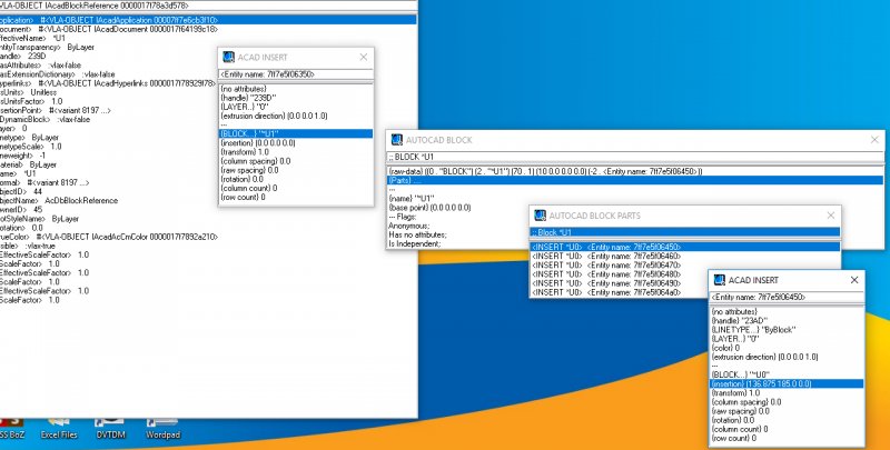

rlx Posted February 28, 2018 Share Posted February 28, 2018 I do appreciate your efforts rlx... I ran entget and vlax-dump-object on it and didn't find any usable coordinates... Only one I found is the origin of the block which is 0,0,0 If you select an array with the properties dialog from autocad you do find the basepoint but in the vla prop's there's not. Command: SO ; IAcadLWPolyline: AutoCAD Lightweight Polyline Interface ; Property values: ; Application (RO) = # ; Area (RO) = 383.594 ; Closed = -1 ; ConstantWidth = 0.0 ; Coordinate = ...Indexed contents not shown... ; Coordinates = (-8.125 0.0 -1.875 23.75 8.125 -1.25 ... ) ; Document (RO) = # ; Elevation = 0.0 ; EntityTransparency = "ByLayer" ; Handle (RO) = "239E" ; HasExtensionDictionary (RO) = 0 ; Hyperlinks (RO) = # ; Layer = "0" ; Length (RO) = 100.606 ; Linetype = "ByLayer" ; LinetypeGeneration = 0 ; LinetypeScale = 1.0 ; Lineweight = -1 ; Material = "ByLayer" ; Normal = (0.0 0.0 1.0) ; ObjectID (RO) = 42 ; ObjectName (RO) = "AcDbPolyline" ; OwnerID (RO) = 43 ; PlotStyleName = "ByLayer" ; Thickness = 0.0 ; TrueColor = # ; Visible = -1 Guess information is barried a little deeper Quote Link to comment Share on other sites More sharing options...
rlx Posted February 28, 2018 Share Posted February 28, 2018 However, if I convert the polar array object back to ename and dig a little deeper I find entry {block} *U1 and if I go down I get {parts} and the first entry of *U0 shows the correct basepoint , in my case 136,185. So it should be possible but I'm note sure at this moment how to get there programmatically. Quote Link to comment Share on other sites More sharing options...
eimimitu Posted February 28, 2018 Author Share Posted February 28, 2018 cool.. it looks like you're onto something... however, how did you get there? First window looks the same for me "VLA-OBJECT"... but when I double click "Application" it gives me a different window Quote Link to comment Share on other sites More sharing options...
rlx Posted February 28, 2018 Share Posted February 28, 2018 cool.. it looks like you're onto something... however, how did you get there? First window looks the same for me "VLA-OBJECT"... but when I double click "Application" it gives me a different window usually the data is hiding in the sub entities , group codes 330 / 360 etc but I searched most of them through lisp with no succes so far ... something like those famous russian dolls within a doll. It looks like I have to seach for a vertex parameter. Tried dxf the drawing and found the parameter (AcDbAssocVertexActionParam) but it seems only C# is able to get to it. Dont have the data on my notebook here at home but on the pc at my work. Maybe there's another way but I haven't found it ... yet... but if I will , I'll let you know ofcourse. gr. Rlx Quote Link to comment Share on other sites More sharing options...
Grrr Posted February 28, 2018 Share Posted February 28, 2018 .. something like those famous russian dolls within a doll. Matrioshkas, although you could find "larger ones" in the code. BTW I was able to dig into the main block definition, from there to dig-out the block references (the diamonds in your picture), and extract their base points. Also I found the base point of the main block reference - But the disappointing part was when I entmaked point entities on these insertion points to preview if graphically they are correct (answer: no - they require translation). And BTW to keep "digging" in the last dialog you popped, you have to right click->inspect raw data to see the dxf list. Quote Link to comment Share on other sites More sharing options...

Lee Mac Posted February 28, 2018 Share Posted February 28, 2018 Here's one way - (defun LM:PolarArrayCenter ( ent / bpt enx rad sta ) (if (and (setq enx (entget ent)) (= "INSERT" (cdr (assoc 0 enx))) (setq enx (member '(102 . "{ACAD_REACTORS") enx)) (setq enx (assoc 330 enx)) (setq enx (entget (cdr enx))) (= "ACDBASSOCDEPENDENCY" (cdr (assoc 0 enx))) (setq enx (assoc 330 enx)) (setq enx (entget (cdr enx))) (= "ACDBASSOCACTION" (cdr (assoc 0 enx))) (setq rad (cdr (assoc 40 (member '(1 . "Radius") enx)))) (setq sta (cdr (assoc 40 (member '(1 . "StartAngle") enx)))) (setq enx (assoc 360 enx)) (setq enx (entget (cdr enx))) (= "ACDBASSOCARRAYACTIONBODY" (cdr (assoc 0 enx))) (setq bpt (cdr (assoc 11 enx))) ) (polar bpt sta (- rad)) ) ) Quote Link to comment Share on other sites More sharing options...
