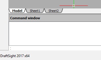

eldon Posted February 20, 2018 Posted February 20, 2018 I opened up DraftSight, and the command prompt is at the bottom of the Command window, and is shown by the colon. My version does not have the word 'Prompt'. Quote

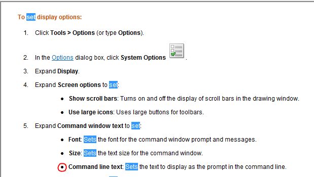

ReMark Posted February 20, 2018 Posted February 20, 2018 jim007: Do NOT reinstall. Here you go. Options > System Options > Display > Command window text > Command line text. Type in the word Prompt (no colon), click on Apply then OK. Return to drawing to verify it worked. Quote

jim007 Posted February 20, 2018 Author Posted February 20, 2018 jim007: Do NOT reinstall. Here you go. Options > System Options > Display > Command window text > Command line text. Type in the word Prompt (no colon), click on Apply then OK. Return to drawing to verify it worked. Thanks ReMark but no nothing happens. Quote

ReMark Posted February 20, 2018 Posted February 20, 2018 Thanks ReMark but no nothing happens. Sorry, but I find that difficult to believe. The default display is just a plain colon without the word Prompt. Quote

ReMark Posted February 20, 2018 Posted February 20, 2018 Why? Do you have the money to rent it on a monthly or yearly basis? From the Draftsight Help file.... BTW...I have DS on my computer as it is what we have our engineering interns use. I did test the above procedure, three times, and it does work. Quote
