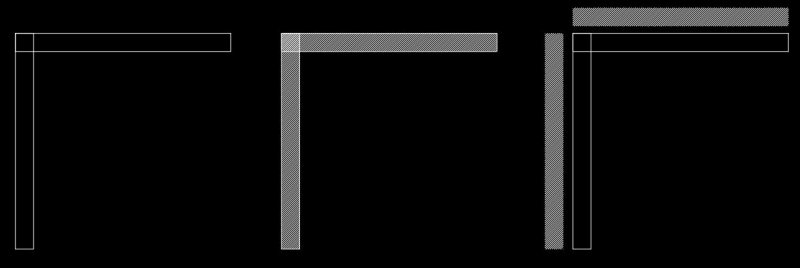

ReMark Posted February 14, 2018 Posted February 14, 2018 I just use a crossing window and pick everything in one feel swoop and it works for me. The only downside, if you want to call it that, is the square in the corner ends up getting hatched twice. Its as though you hatched each long rectangle separately then overlapped them. See for yourself... Quote

ReMark Posted February 14, 2018 Posted February 14, 2018 Just to be clear, I did not pick inside each individual area. I used a crossing window that passed through both objects at the same time. Quote
SLW210 Posted February 14, 2018 Posted February 14, 2018 See this thread from 2011. Autodesk has had seven years to address this issue. Oh wait, they don't do issues. Works just like ReMark shows in AutoCAD 2018, not sure what release, but it is fixed now. Quote

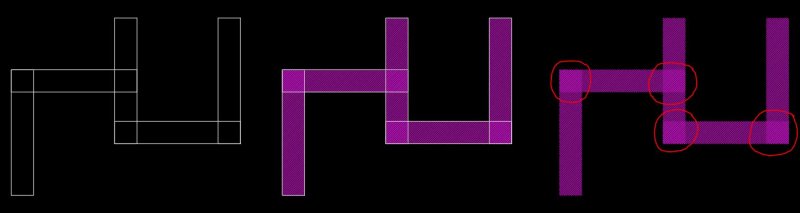

ReMark Posted February 15, 2018 Posted February 15, 2018 I guess I wasn't clear enough. I did not select the rectangles separately. Here's another example that I tested a half dozen times and got the same results each time. Everything got hatched even the areas (the squares) that were overlapping using one crossing window for making the selection. The square areas (four) got hatched twice. Quote
