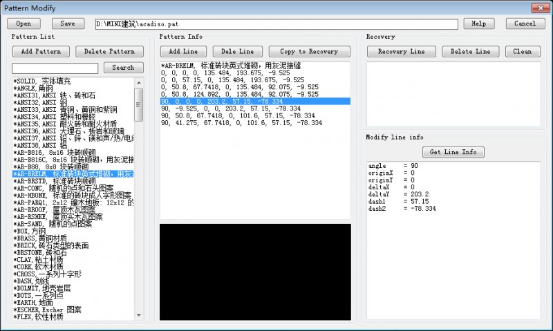

belx Posted February 11, 2018 Posted February 11, 2018 How to preview a pattern? HighLight the select line and Refresh after modify a line. PatternModify.rarFetching info... Quote
belx Posted February 11, 2018 Author Posted February 11, 2018 (defun c:pm() ;------------------------- (defun parsestr->lst (str / LST POS str) (while (setq pos (vl-string-search "," str)) (setq lst (cons (vl-string-left-trim " "(substr str 1 pos)) lst) str (substr str (+ pos 2)) ) ) (if (> (strlen str) 0) (setq lst (cons (vl-string-left-trim " " str) lst)) ) (reverse lst) ) ;------------------------- ;(joinlst->str (list "1" "2" "3" "4" "5" "6")) (defun joinlst->str (lst / LST POS str) (setq str "") (while lst (setq x (car lst)) (if (setq lst(cdr lst)) (setq str (strcat str x ",")) (setq str (strcat str x)) ) ) str ) ;------------------------- (defun subst-index(var n lst / i) (setq i -1) (mapcar '(lambda(x) (if (= n (setq i (1+ i))) var x)) lst) ) ;-----------DELETE A ITOM-------------- ;(delete-index 1 '((1 2 3) (4 5 6)(7 8 9))) (defun delete-index(n lst / i) (setq i -1) (vl-remove-if '(lambda(x) (= (setq i (1+ i)) n)) lst) ) ;-----------INSERT A ITOM-------------- ;(add-index "A" -1 '(0 1 2 3 4 5)) (defun add-index(var n lst / len i newlst) (setq len (length lst)) (cond ((< n 0) (setq newlst (cons var lst)) ) ((>= n len) (setq newlst (reverse(cons var (reverse lst)))) ) (t (setq i -1 newlst nil) (foreach itom lst (if (= n (setq i (1+ i))) (setq newlst (cons itom newlst) newlst (cons var newlst) ) (setq newlst (cons itom newlst)) ) ) (setq newlst (reverse newlst)) ) ) newlst ) ;------------------------- (defun LM:editbox ( str / han ) (and (< 0 (setq han (load_dialog "acad"))) (new_dialog "acad_txtedit" han) (set_tile "text_edit" str) (action_tile "text_edit" "(setq str $value)") (if (zerop (start_dialog)) (setq str nil)) ) (if (< 0 han) (unload_dialog han)) str ) ;------------------------- (defun readpatfile(file / files fn PatternList pat x fn) (if (and (setq files(findfile file)) (setq fn (open files "r")) ) (progn (setq PatternList NIL pat nil) (while (setq x (read-line fn)) (cond ((wcmatch X "`**") (if pat (setq PatternList (cons (reverse pat) PatternList)) ) (setq pat nil pat (cons x pat) ) ) ((wcmatch X "#*#*#*#*") (setq pat(cons x pat)) ) (t nil) ) ) (setq PatternList (cons (reverse pat) PatternList)) (close fn) ) ) (reverse PatternList) ) ;------------------------- (defun show_list(key newlist) (start_list key) (mapcar 'add_list newlist) (end_list) ) ;------------------------- (defun act_open() (if (setq patfile(getfiled "SELECT A FILE(.PAT) TO OPEN" (get_tile "patfile") "pat" 2)) (progn (setq PatternList (readpatfile patfile)) (show_list "patnamelst" (mapcar 'car PatternList)) (show_list "patterninfo" nil) ) ) ) (defun act_save( / fn) (if (and (setq patfile(getfiled "SELECT A FILE(.PAT) TO SAVE" (get_tile "patfile") "pat" 2)) (setq fn (open patfile "w")) ) (progn (foreach x PatternList (foreach y x (write-line y fn) ) (write-line ";-----------------" fn) ) (close fn) ) ) ) ;-----------SSGET TO PATTERN-------------- ;------------getpatlinestr------------- (defun getpatlinestr(/ patlinestr PT0 startpt angpt deltax deltay ang originx originy i ptn0 ptn1 dash) (if (and (setq PT0 (getpoint"\n Base point:")) (setq startpt(getpoint"\n Start point:")) (setq angpt(getpoint startpt "\n Angle:")) (or(setq deltax (getdist"\n deltaX<0>:"))(setq deltax 0)) (or(setq deltay (getdist"\n deltaY<0>:"))(setq deltay 0)) ) (progn (setq ang (angtos(angle startpt angpt)0 4) originx (rtos(- (car startpt) (car pt0))) originy (rtos(- (cadr startpt) (cadr pt0))) patlinestr (strcat ang "," originx "," originy "," (rtos deltax) "," (rtos deltax)) ) (setq i 1 ptn0 startpt) (while (setq ptn1 (getpoint ptn0 (strcat "\n Get dash" (if (= (rem (setq i (1+ i)) 2)0) "CONTINOUS" "NONE")"distance<EXIT>:"))) (setq dash (rtos(distance ptn0 ptn1)) patlinestr (strcat patlinestr "," dash) ptn0 ptn1 ) ) ) ) patlinestr ) ;----------DELETE PATTERN--------------- (defun act_delpattern() (if (and (setq patlstn(get_tile "patnamelst")) (setq patlstn (atoi patlstn)) ) (progn (setq PatternList (delete-index patlstn PatternList)) (show_list "patnamelst" (mapcar 'car PatternList)) (set_tile "patnamelst" (itoa patlstn)) ) ) ) ;----------search pattern--------------- (defun act_searchpattern(/ searchstr) (if (/= (setq searchstr(get_tile "searchstr"))"") (progn (setq tempatlst (vl-remove-if-not '(lambda(x)(wcmatch (car x) (strcat"*" searchstr "*")))PatternList)) (show_list "patnamelst" (mapcar 'car tempatlst)) (set_tile "patnamelst" "0") ) ) ) ;----------ADD ONE LINE--------------- (defun act_addline() (if (setq patterninfon (get_tile "patterninfo")) (setq patterninfon (atoi patterninfon)) (setq patterninfon (length patterninfo)) ) (setq patterninfo (add-index "Angle,StartX,StartY,DeltaX,DeltaY" patterninfon patterninfo)) (show_list "patterninfo" patterninfo) (set_tile "patterninfo" (itoa (1+ patterninfon))) (act_patvauelst) ) ;----------DELETE ONE LINE--------------- (defun act_deline() (if (and (setq patterninfon (get_tile "patterninfo")) (setq patterninfon (atoi patterninfon)) ) (progn (setq patterninfo (delete-index patterninfon patterninfo)) (show_list "patterninfo" patterninfo) (set_tile "patterninfo" (itoa patterninfon)) (if patterninfo (act_patvauelst)) ) (alert "NEED TO SELECT A LINE.") ) ) ;----------COPY TO recovery--------------- (defun act_copyline() (if (and (setq patterninfon (atoi(get_tile "patterninfo"))) (setq patlinestr (nth patterninfon patterninfo));该行的字符串 ) (progn (setq recoverylst (reverse(cons patlinestr (reverse recoverylst)))) (show_list "recoverylst" recoverylst) (set_tile "recoverylst" (itoa (1-(length recoverylst)))) ) (alert "NEED TO SELECT A LINE.") ) ) ;----------recovery A LINE--------------- (defun act_recovery() (if (and (setq patterninfon (get_tile "patterninfo")) (setq patterninfon (atoi patterninfon)) (setq recoverylstn (atoi(get_tile "recoverylst"))) (setq patlinestr (nth recoverylstn recoverylst)) ) (progn (setq patterninfo (add-index patlinestr patterninfon patterninfo)) (show_list "patterninfo" patterninfo) (set_tile "patterninfo" (itoa patterninfon)) ) (alert "Need to select a line in recovery and Selece insert position.") ) ) ;----------DELETE A LINE IN recovery--------------- (defun act_recoverydel() (if (and (setq recoverylstn (get_tile "recoverylst")) (setq recoverylstn (atoi recoverylstn)) ) (progn (setq recoverylst (delete-index recoverylstn recoverylst)) (show_list "recoverylst" recoverylst) (if recoverylstn (set_tile "recoverylst" (itoa recoverylstn))) ) (alert "NEED TO SELECT A LINE.") ) ) ;----------CLEAN recovery--------------- (defun act_recoveryclean() (setq recoverylst nil) (show_list "recoverylst" recoverylst) ) ;------------------------- (defun act_patnamelst() (setq patlstn (atoi(get_tile "patnamelst")) patterninfo (nth patlstn PatternList) ) (show_list "patterninfo" patterninfo) (set_tile "patterninfo" "0") (act_patvauelst) ) ;------------------------- (defun act_patvauelst( / leard) (setq patterninfon (atoi(get_tile "patterninfo")) patlinestr (nth patterninfon patterninfo) infolst (parsestr->lst patlinestr) ) (if (wcmatch patlinestr "`**") (progn (mode_tile "getinfo" 1) (setq leard (list "PatternName" "Description")) ) (progn (mode_tile "getinfo" 0) (setq leard (list "angle" "originX" "originY" "deltaX" "deltaY" "dash1" "dash2" "dash3" "dash4" "dash5" "dash6" "dash7" "dash8" "dash9"))) ) (setq infolst (mapcar '(lambda(x y)(cons x y)) leard infolst)) (show_list "infolst" (mapcar '(lambda (x) (strcat (car x)"\t= " (cdr x)))infolst)) ) ;------------------------- (defun act_infolst( / var str) (if (and (setq var (nth infolstn infolst)) (setq str (LM:editbox (cdr var))) ) (progn (setq infolst (subst-index (cons (car var) str) infolstn infolst); patlinestr (joinlst->str (mapcar 'cdr infolst)); patterninfo (subst-index patlinestr patterninfon patterninfo); PatternList (subst-index patterninfo patlstn PatternList); ) (show_list "patterninfo" patterninfo) (set_tile "patterninfo" (itoa patterninfon)) (show_list "infolst" (mapcar '(lambda (x) (strcat (car x)"\t= " (cdr x)))infolst)) (set_tile "infolst" (itoa infolstn)) ) ) ) ;------------------------- (defun showdcl() (if (and(setq dclfile(findfile "PatternModify.dcl")) (>= (setq DCLID (load_dialog dclfile)) 0) ) (progn (new_dialog "pat" DCLID) (set_tile "patfile" patfile) (if PatternList (show_list "patnamelst" (mapcar 'car PatternList))) (if patterninfo(show_list "patterninfo" patterninfo)) (if recoverylst(show_list "recoverylst" recoverylst)) (if infolst(show_list "infolst" (mapcar '(lambda (x) (strcat (car x)"\t= " (cdr x)))infolst))) ;(if dcldata (setdcldata)) (action_tile "open" "(act_open)") (action_tile "save" "(act_save)") (action_tile "delpattern" "(act_delpattern)") (action_tile "searchbut" "(act_searchpattern)") (action_tile "addline" "(act_addline)") (action_tile "deline" "(act_deline)") (action_tile "copyline" "(act_copyline)") (action_tile "recovery" "(act_recovery)") (action_tile "recoverydel" "(act_recoverydel)") (action_tile "recoveryclean" "(act_recoveryclean)") (action_tile "patnamelst" "(act_patnamelst)") (action_tile "patterninfo" "(act_patvauelst)") (action_tile "infolst" "(setq infolstn (atoi $value)) (if(= $reason 4) (act_infolst))") ;(action_tile "open" "(act_openpatfile)") (action_tile "cancel" "(done_dialog)") (action_tile "addpattern" "(done_dialog 11)") (action_tile "getinfo" "(done_dialog 12)") ;(action_tile "accept" "(getdcldata)(done_dialog 0)") (setq return (start_dialog)) (cond ((= return 11) (princ) ) ((= return 12) (if (setq patlinestr (getpatlinestr)) (setq patterninfo (add-index patlinestr patterninfon patterninfo)) ) (showdcl) ) (t nil) ) ) ) ) ;------------------------- (if (not PatternList) (setq patfile (findfile "acadiso.pat") PatternList (readpatfile patfile ) ) ) (showdcl) ) ;---------------------- /*★★★★★ListDCL @ fsxm.mjtd.com★★★★★*/ pat:dialog { label = "Pattern Modify" ; :row { :button { key = "open" ; fixed_width = true ; label = "Open" ; } :button { fixed_width = true ; key = "save" ; label = "Save" ; } :edit_box { key = "patfile" ; width = 100 ; } :button { fixed_width = true ; key = "help" ; label = "Help" ; } :button { fixed_width = true ; is_cancel = true ; label = "Cancel" ; } } :row { :boxed_column { label = "Pattern List" ; children_fixed_height = true ; :row { fixed_height = true ; :button { fixed_width = true ; key = "addpattern" ; label = "Add Pattern" ; } :button { fixed_width = true ; key = "delpattern" ; label = "Delete Pattern" ; } } :row { fixed_height = true ; :edit_box { key = "searchstr" ; } :button { key = "searchbut" ; fixed_width = true ; label = "Search" ; } } :list_box { height = 35 ; key = "patnamelst" ; width = 30 ; } } :boxed_column { children_fixed_height = true ; label = "Pattern Info" ; :row { fixed_height = true ; :button { fixed_width = true ; key = "addline" ; label = "Add Line" ; } :button { fixed_width = true ; key = "deline" ; label = "Dele Line" ; } :button { fixed_width = true ; key = "copyline" ; label = "Copy to Recovery" ; } } :list_box { key = "patterninfo" ; width = 45 ; height = 24 ; } :image { key = "img" ; aspect_ratio = 0.6 ; color = -2 ; width = 45 ; } } :column { :boxed_column { label = "Recovery" ; :row { fixed_height = true ; :button { fixed_width = true ; key = "recovery" ; label = "Recovery Line" ; } :button { fixed_width = true ; key = "recoverydel" ; label = "Delete Line" ; } :button { fixed_width = true ; key = "recoveryclean" ; label = "Clean" ; } } :list_box { key = "recoverylst" ; fixed_height = true ; } } :boxed_column { children_alignment = centered ; label = "Modify line info" ; :button { fixed_width = true ; key = "getinfo" ; label = "Get Line Info" ; } :list_box { key = "infolst" ; tabs = "10" ; height = 23 ; } } } } } Quote

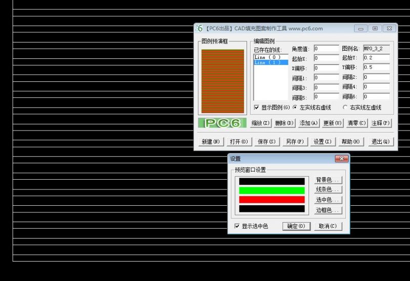

belx Posted February 27, 2018 Author Posted February 27, 2018 Haha, find a pattern making tool, and what I want is the way it looks. Quote
