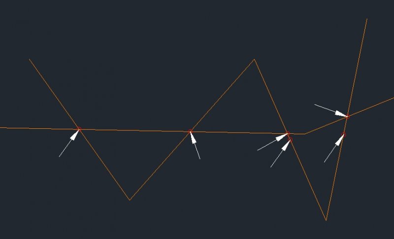

Kowal Posted February 6, 2018 Share Posted February 6, 2018 I am analyzing the function of Lee Mac. http://www.lee-mac.com/intersectionfunctions.html ;; Intersections - Lee Mac ;; Returns a list of all points of intersection between two objects ;; for the given intersection mode. ;; ob1,ob2 - [vla] VLA-Objects ;; mod - [int] acextendoption enum of intersectwith method (defun LM:intersections ( ob1 ob2 mod / lst rtn ) (if (and (vlax-method-applicable-p ob1 'intersectwith) (vlax-method-applicable-p ob2 'intersectwith) (setq lst (vlax-invoke ob1 'intersectwith ob2 mod)) ) (repeat (/ (length lst) 3) (setq rtn (cons (list (car lst) (cadr lst) (caddr lst)) rtn) lst (cdddr lst) ) ) ) (reverse rtn) ) I noticed that if the coordinates are large, the function catches the neighboring segments. Example 1: intersections two LWPOLYLINE. (LM:intersections (vlax-Ename->Vla-Object (car (entsel))) (vlax-Ename->Vla-Object (car (entsel))) acextendnone) LWPOLYLINE 1: ((-0.112 0.093) (0.296 0.085) (0.717 0.255)) LWPOLYLINE 2: ((-0.043 0.177) (0.08 0.003) (0.234 0.177) (0.323 -0.022) (0.373 0.227)) Returns 4 correct points. ((0.0180291 0.090385 0.0) (0.155541 0.0875826 0.0) (0.275268 0.0851427 0.0) (0.34906 0.106104 0.0)) Example 2: intersections two LWPOLYLINE transformed. LWPOLYLINE 1: ((8405375.127 5679451.655) (8405375.535 5679451.647) (8405375.955 5679451.818)) LWPOLYLINE 2: ((8405375.195 5679451.739) (8405375.319 5679451.565) (8405375.473 5679451.739) (8405375.562 5679451.54) (8405375.612 5679451.789)) Returns 6 points. 4 correct and 2 incorrect. ((8.40538e+006 5.67945e+006 0.0) (8.40538e+006 5.67945e+006 0.0) (8.40538e+006 5.67945e+006 0.0) (8.40538e+006 5.67945e+006 0.0) (8.40538e+006 5.67945e+006 0.0) (8.40538e+006 5.67945e+006 0.0)) Is the only solution to move the objects to the beginning of the coordinate system for the time when calculating the intersections? Quote Link to comment Share on other sites More sharing options...
Lee Mac Posted February 6, 2018 Share Posted February 6, 2018 This is unfortunately a known bug with the intersectwith method - it has been discussed previously here. 1 Quote Link to comment Share on other sites More sharing options...
Grrr Posted February 6, 2018 Share Posted February 6, 2018 Interesting, however I'm unable to reproduce this bug... Thought to suggest using a function like the polyinters Lee offered (no idea he wrote such thing already ). The only failure of the intersectwith method of which I was aware is: (setq rtn ; in case the object is self intersecting (cons ; but the problem is that this considers LWPOLY's/SPLINE's mid vertices as intersections (i.e. all vertices, except the endpoints) (vlax-list->3D-point (vlax-invoke o1 'InterSectWith o1 acExtendNone)) rtn ) ); setq rtn BTW a variation of Lee's function that uses vlax-curveGetPointAtParam to split the curve at segments and use inters for every pair of segments from the two curve objects might "do the job", although this approach would vary on precision and speed performance. Maybe more effective way for this idea would be to incorporate it with this. Quote Link to comment Share on other sites More sharing options...
