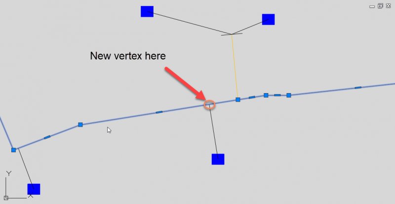

Hi all,
I'm trying write a LISP routine which will accomplish the following:
1. Select the block reference on the drawing
2. Find the closest polyline and closest point on that polyline from this block reference
3. Create vertex on that point and save the coordinates of this point into a variable for further use
4. Extract Object Data such as SerialNo (please refer to the screenshot attached) from that block reference
5. Loop for each block reference
6. Export the point's coordinates saved earlier and its corresponding SerialNo into txt or csv which will look like:
X_coord, Y_coord, SerialNo
E.g. 85.4535, 18.7903, 09I4E5Q2104022719
or 85.4535, 18.7903, 09I4E5Q2104022311, 09I4E5Q2104022719 (if it has more than one block reference)
The output file is interpreted as the electric line having the load on that particular point.

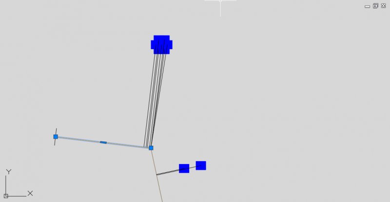

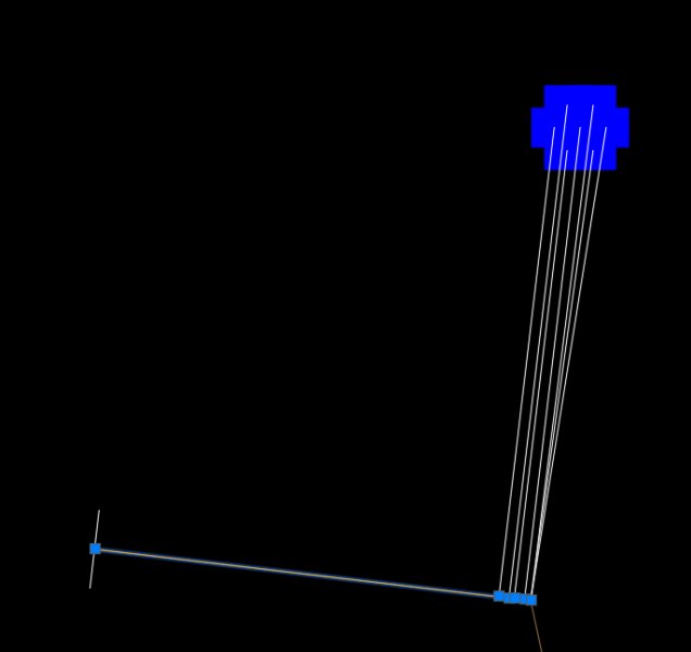

Thank you for your response. I run this code and when I try to select block references they are not selected. Thank you
Here's a quick one to get you started. I've put comments so you can edit the code to suit your needs exactly.

The only thing I would need is creating new vertex on polyline where the closest point is as shown on the picture. How would you suggest to modify this?
Thank you. Your help is greatly appreciated
I updated the code .. give it a try. Remember to tip your waiter :P.
One last thing. Hope you're not fed up with this :)
How do you create new vertices on the polyline shown on the picture?
Thanks
Check your personal messages .. I already addressed that.
