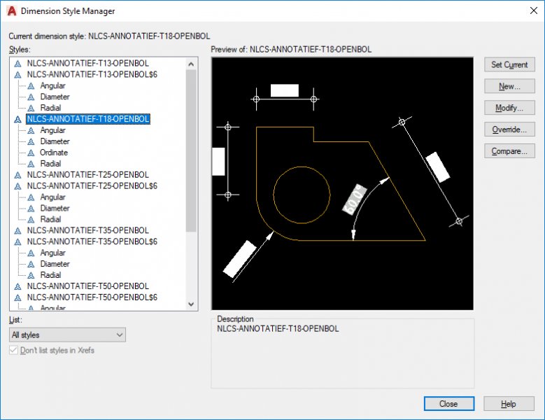

When i open my template i have these styles:
When i Purge => PurgeAll my template, there all deleted as supposed.
Now the problem:
When i use the 'Quick method to import all DimStyles from template:
(Steal "W:\\Template.dwt" '(("Dimension Styles"("*"))))
I get the following result:
As you can see, all styles (exept current) get imported on a buggy way.
The 'ordinate' styles are missing, and the regular style is added with a $6 tag?

Apart from having a specific name ("*@*") these child dimension styles are the same as any other style which explains the behavior you see.

I'm a big fan and heavy user of Lee Mac's Steal routine, but Dimension Styles are complicated since most of them are dependent modifications of another Dimension Style.
I never modify or use the Standard Dimension Style as all others are Standard + Modifications.
Using Design Center you need to add parent styles first then add child styles for say Angular dimensions afterwards.
Doubt if there's any way Lee's routine could tell what order to load them.

After a cursory review of the issue you have reported and without performing any testing myself, I believe the difference in the behaviour that you are witnessing between using the application with the program dialog and evaluating the function directly with a wildcard argument is the order in which the objects are imported into the active drawing.
To test this theory, please try changing line 683 from:
                                    tmp
to:
                                    (reverse tmp)
