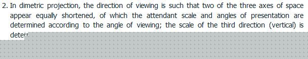

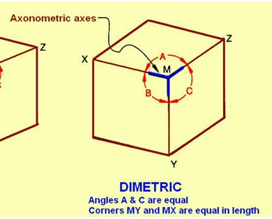

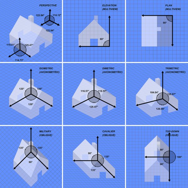

eldon Posted January 31, 2018 Share Posted January 31, 2018 I think that you would have better information by searching on the web. I googled it, and found this site full of most excellent information on Axonometric projections. Quote Link to comment Share on other sites More sharing options...

SLW210 Posted January 31, 2018 Share Posted January 31, 2018 Your example looks closer to Trimetric to me. Quote Link to comment Share on other sites More sharing options...
basty Posted January 31, 2018 Author Share Posted January 31, 2018 I think that you would have better information by searching on the web. I googled it, and found this site full of most excellent information on Axonometric projections. I read in your above link about dimetric. It doesn't show how to draw a dimetric cube. Can someone show me how to draw dimetric by a projection method? Quote Link to comment Share on other sites More sharing options...
eldon Posted January 31, 2018 Share Posted January 31, 2018 ..........It doesn't show how to draw a dimetric cube...... Really??? There was a welter of information. Perhaps you did not read far enough. It will never say "Start the line command" and "Draw a line". You have to interpret the information and draw it for yourself. This is part of the information. I am sure that plenty of folk here could make a good fist at drawing a Dimetric Cube. Quote Link to comment Share on other sites More sharing options...
