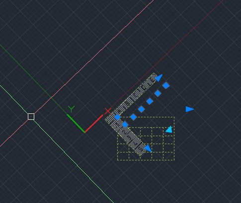

I'm inserting new table using this routine:
(defun cd:ACX_AddTable (Space Pb Rows Cols RowH ColH)
 (vla-AddTable
    Space
    (vlax-3d-point (trans Pb 1 0))
    Rows
    Cols
    RowH
    ColH
Example :
(cd:ACX_AddTable (cd:ACX_ASpace) (getpoint) 5 5 10 30)
but I'm don't know how to rotate inserted table to current UCS.
I'm guessing that this have something in common with direction property but I'm stuck here...
Any help ?

Try this
(setq table
 (vla-AddTable
    Space
    Rows
    Cols
    RowH
    ColH
(vlax-put table 'direction (trans '(1 0 0) 1 0 T))
I never had this problem. It seems it appears like this if you just insert the table.
vla-update doesn't help, but it comes to normal as soon as you start populating the cells or adjust the rows, columns.
Even a vla-move will regenerate it.
(setq table
 (vla-AddTable
    Space
    (vlax-3d-point 0.0 0.0 0.0)
    Rows
    Cols
    RowH
    ColH
(vla-move table (vlax-3d-point 0.0 0.0 0.0) (vlax-3d-point (trans Pb 1 0)))
