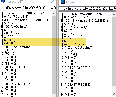

ronjonp Posted January 29, 2018 Posted January 29, 2018 That index color should change even if you apply a truecolor: Quote

ronjonp Posted January 29, 2018 Posted January 29, 2018 If you're just filtering them, GC 62 should work just fine. Quote
Lee Mac Posted January 29, 2018 Posted January 29, 2018 You're welcome Dennis, glad the conversion functions could help. If you're just filtering them, GC 62 should work just fine. I wouldn't rely on DXF 62 in this case, as there isn't a one-to-one mapping between RGB and ACI, but rather many RGB colours approximated to a single ACI. Quote
ronjonp Posted January 29, 2018 Posted January 29, 2018 You're welcome Dennis, glad the conversion functions could help. I wouldn't rely on DXF 62 in this case, as there isn't a one-to-one mapping between RGB and ACI, but rather many RGB colours approximated to a single ACI. Agreed .. never thought of it that way. Quote
