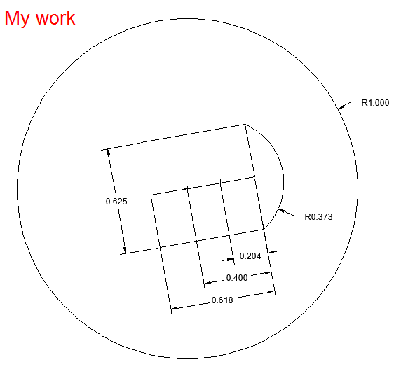

basty Posted February 10, 2018 Author Posted February 10, 2018 steven-g said: You have to give the OP points for being persistent (and thick-skinned). I'm taking bets even this results in more questions [ATTACH=CONFIG]63233[/ATTACH] I still don't understand. This is what I am be able to draw (see below pic). What to do next? Arc.dwgFetching info... Quote

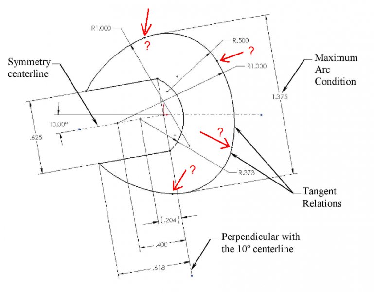

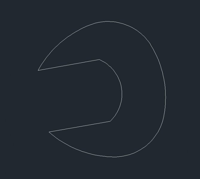

Cad64 Posted February 10, 2018 Posted February 10, 2018 basty said: I still don't understand. This is what I am be able to draw (see below pic). What to do next? All the information you need is provided in the drawing. The fact that you're unable to figure out how to draw this is due to your obvious lack of training and understanding of what you're looking at. As I have mentioned numerous times, you need classroom training. The center point for one of the R1.000 arcs is identified on the drawing. You even put the .400 dimension on your drawing but haven't drawn the circle. You are also given a maximum arc condition of 1.375. Knowing those two pieces of information, along with the .618 dimension, is all you need to draw the (3) R1.000 arcs. Once you have those drawn, all you have to do is use the TTR option of the Circle command to create the (2) R.500 arcs. Then Trim and Delete to clean up the drawing. I created this in less than 5 minutes. Quote
basty Posted February 10, 2018 Author Posted February 10, 2018 (edited) Cad64 said: All the information you need is provided in the drawing. The fact that you're unable to figure out how to draw this is due to your obvious lack of training and understanding of what you're looking at. As I have mentioned numerous times, you need classroom training. The center point for one of the R1.000 arcs is identified on the drawing. You even put the .400 dimension on your drawing but haven't drawn the circle. You are also given a maximum arc condition of 1.375. Knowing those two pieces of information, along with the .618 dimension, is all you need to draw the (3) R1.000 arcs. Once you have those drawn, all you have to do is use the TTR option of the Circle command to create the (2) R.500 arcs. Then Trim and Delete to clean up the drawing. I created this in less than 5 minutes. What is "maximum arc condition"? I know the center of the R1.000 is 0.400 but I don't know where the point of this arc is start and end (see below pic). Can you tell me how? Edited February 10, 2018 by basty Quote

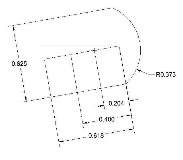

basty Posted February 10, 2018 Author Posted February 10, 2018 This is what I done so far (see below pic). What to do next? Arc.dwgFetching info... Quote
ReMark Posted February 10, 2018 Posted February 10, 2018 What do you do next? Go back and reread post #80, 88, 92, 96 and 106 as each one of them explain in words and/or images exactly what to do. There really is no sense in repeating information ad infinitum. Quote
basty Posted February 10, 2018 Author Posted February 10, 2018 (edited) ReMark said: What do you do next? Go back and reread post #80, 88, 92, 96 and 106 as each one of them explain in words and/or images exactly what to do. There really is no sense in repeating information ad infinitum. None of those posts you mentioned above can make me understand and draw the arcs. See below pic for the work I done. Can somebody just tell me what is the next step? Edited February 10, 2018 by basty Quote
Cad64 Posted February 10, 2018 Posted February 10, 2018 basty said: None of those posts you mentioned above can make me understand and draw the arcs. See below pic for the work I done. Can somebody just tell me what is the next step? It has been explained to you several times, by several different people. The problem is that you don't have basic drafting knowledge or ability. We can't teach you how to be a drafter. You need to go to school in order to learn the skills necessary to do this type of work. Quote
eldon Posted February 10, 2018 Posted February 10, 2018 I had never before come across the term "Maximum Arc Condition". But looking at the diagram, it is apparent to me what it means. This experience is what you lack, and I am unable to spoon-feed you further. This sort of terminology is used in real life, and you have to be able to understand it through further education, which is more than the scope of this forum, unless you meet a really, really nice person. Quote
