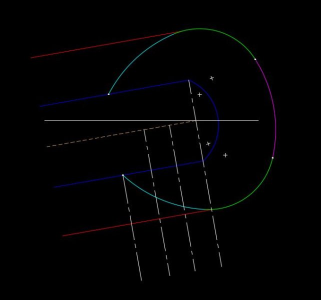

steven-g Posted February 5, 2018 Posted February 5, 2018 No we don't know, but if you draw the things that are shown in the diagram that are clearly dimensioned then there is enough information to work out where the other arc centers are. Just try it, and if you have any questions then use your eyes and reread all your other posts because the answers have been given many times over, by many people. Quote

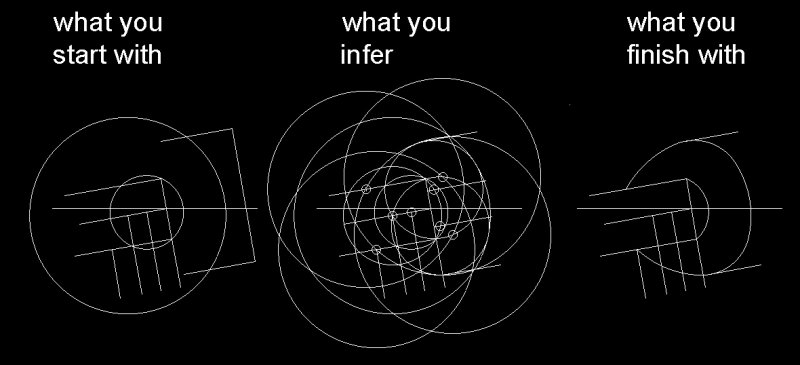

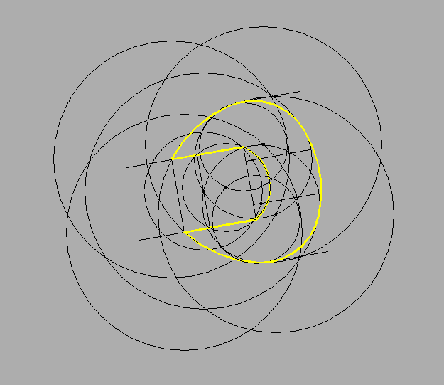

ReMark Posted February 5, 2018 Posted February 5, 2018 (edited) I came up with this quickie. Any relation to being accurate was purely accidental. Edited February 5, 2018 by ReMark Quote
ReMark Posted February 5, 2018 Posted February 5, 2018 Well, theoretically speaking, you could but oh what a mess. Then the horse wouldn't be able to say "Wilbur." Quote

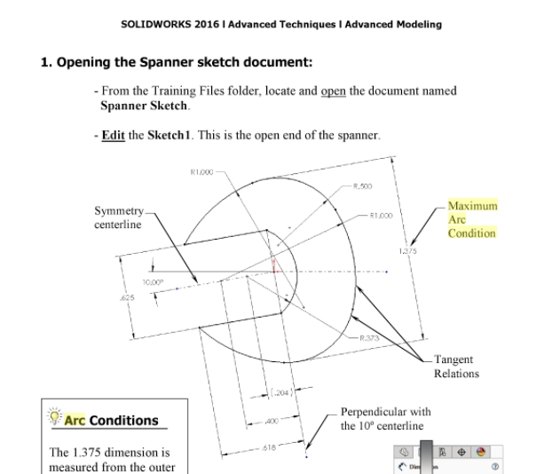

eldon Posted February 5, 2018 Posted February 5, 2018 If you had the Solidworks 2016 Training files folder, then you would have the drawing. Quote
ReMark Posted February 5, 2018 Posted February 5, 2018 Are all the drawings basty has asked for help with taken from the same Solidworks manual? Quote
eldon Posted February 5, 2018 Posted February 5, 2018 ReMark said: Are all the drawings basty has asked for help with taken from the same Solidworks manual? I expect only basty could say. Google only coughs up a page at a time! It only shows the lack of knowledge that is being displayed, because this exercise should be drawn purely by geometry. My earlier response shows what nonsense is the request for coordinates. Quote

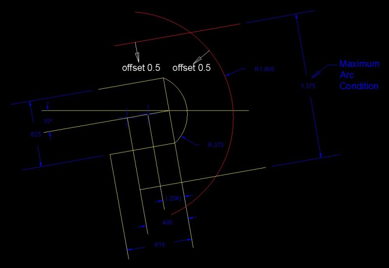

rkent Posted February 5, 2018 Posted February 5, 2018 (edited) I realized I just needed to draw a circle at the .5 center, and a 1" at the left end point and use the intersection of those for the left arc. Basty, the r1 center is given, the r.5 center is found by offsetting the 1" radius by .5, and offsetting a line that established the maximum arc condition, given as 1.375 overall, so divide that in half. Edited February 5, 2018 by rkent Quote
steven-g Posted February 5, 2018 Posted February 5, 2018 All it needs are offsets or arcs from the known geometry of either 0.5 or 1.0 Quote

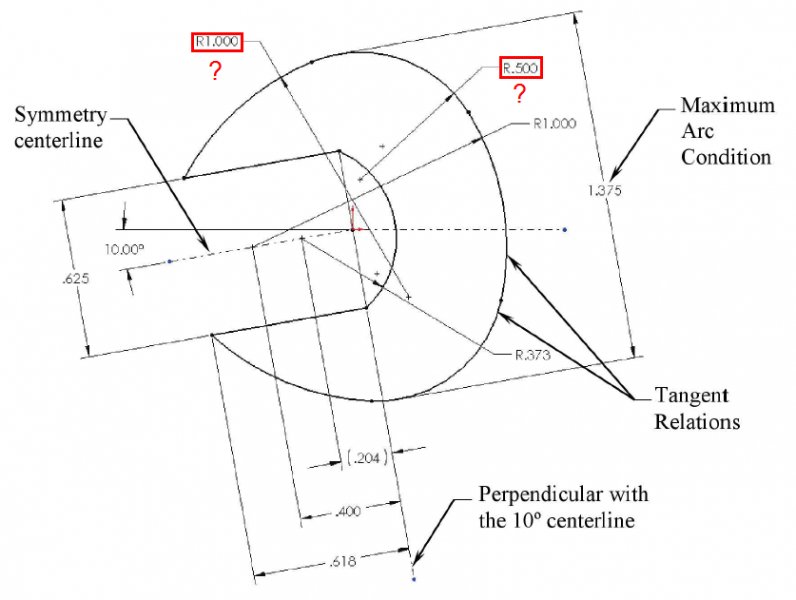

basty Posted February 6, 2018 Author Posted February 6, 2018 How do you find the center of R1.000 and R.500? (see below pic) Quote
eldon Posted February 6, 2018 Posted February 6, 2018 basty said: How do you find the center of R1.000 and R.500? To answer your question in context, it is better to start right at the beginning. The basic geometric fact throughout this exercise, which has arcs tangential to each other, is that for arcs to be tangential, the tangent point and the centres of the two arcs are collinear. Also if an arc passes through a point, then the centre of the arc lies on a circle drawn centred on that point. And if an arc is tangential to a line or arc, then the centre of the arc lies on the line or arc offset by the value of the radius. Bearing the above in mind, one must examine the diagram to see which order to draw the various segments. The obvious place to start is the central 1R arc, the centre is given by dimensions. Then the 0.5r arc. It is tangential to the first arc and also is tangential to the Maximum Arc Condition lines. So offset these lines by 0.5 and offset the first 1R arc by 0.5. The intersection is the centre of the 0.5R arc. Then the second 1R arc. This passes through a point on the inner flat, given by dimension, so draw a 1R circle on that point. It is also tangential to the 0.5R arc, so where the 1R circle, that has just been drawn, intersects with the 0.5R circle, that was drawn previously, is the centre of the second 1R arc. Tidy up all unnecessary linework and there you are. Quote

basty Posted February 6, 2018 Author Posted February 6, 2018 eldon said: To answer your question in context, it is better to start right at the beginning. The basic geometric fact throughout this exercise, which has arcs tangential to each other, is that for arcs to be tangential, the tangent point and the centres of the two arcs are collinear. Also if an arc passes through a point, then the centre of the arc lies on a circle drawn centred on that point. And if an arc is tangential to a line or arc, then the centre of the arc lies on the line or arc offset by the value of the radius. Bearing the above in mind, one must examine the diagram to see which order to draw the various segments. The obvious place to start is the central 1R arc, the centre is given by dimensions. Then the 0.5r arc. It is tangential to the first arc and also is tangential to the Maximum Arc Condition lines. So offset these lines by 0.5 and offset the first 1R arc by 0.5. The intersection is the centre of the 0.5R arc. Then the second 1R arc. This passes through a point on the inner flat, given by dimension, so draw a 1R circle on that point. It is also tangential to the 0.5R arc, so where the 1R circle, that has just been drawn, intersects with the 0.5R circle, that was drawn previously, is the centre of the second 1R arc. Tidy up all unnecessary linework and there you are. I can't read the drawing cause it's too complicated for me, there are too many circles. Can you explain it again but this time a bit slowdown would you? If you don't mind. Quote
