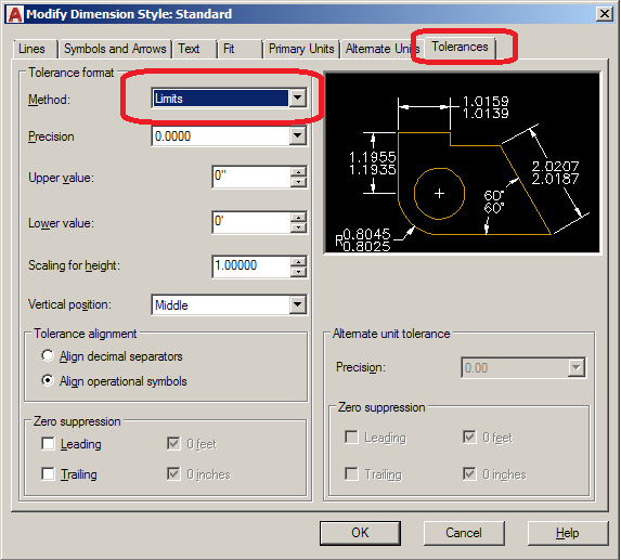

basty Posted February 3, 2018 Author Posted February 3, 2018 (edited) How do you create dimension text like this (see below) where the diameter symbol located between (in the middle) .625 and .623 text? Edited February 3, 2018 by basty Quote

SLW210 Posted February 5, 2018 Posted February 5, 2018 I can't see your images at work, you should post them directly to CADTutor. I would guess, this is what you want. Quote
basty Posted February 5, 2018 Author Posted February 5, 2018 SLW210 said: I can't see your images at work, you should post them directly to CADTutor. I would guess, this is what you want. How do I do that? I change the dim style as you said but the entire dimensions are changing too. Quote
SLW210 Posted February 5, 2018 Posted February 5, 2018 You use different DimStyles or current DimStyle with Child Properties for Diameter, etc. or change them in properties. You really need to take some classes. To post Images to CADTutor, you can use the "Go Advanced" at the lower right of the Reply Box, then select "Manage Attachments" and Browse to the file on your computer and upload. Quote

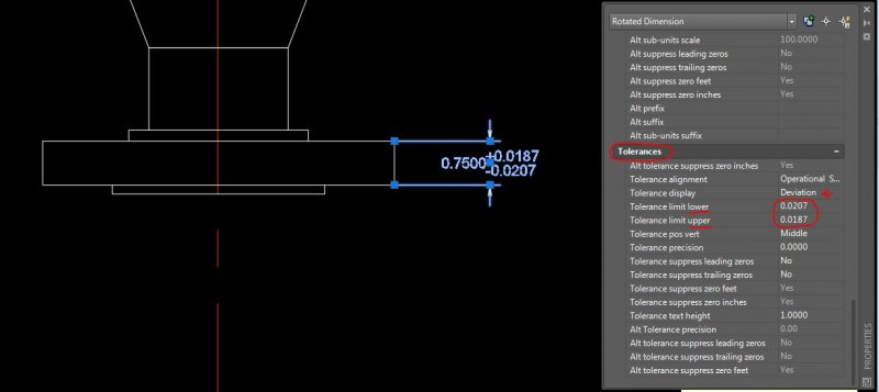

ReMark Posted February 5, 2018 Posted February 5, 2018 basty said: How do I do that? I change the dim style as you said but the entire dimensions are changing too. If you only want to display tolerances for one or two dimensions another option, besides creating a separate dimension style, would be to use the overrides found on your Properties panel under the heading "Tolerances". We look... but we fail to see. Quote
basty Posted February 5, 2018 Author Posted February 5, 2018 ReMark said: If you only want to display tolerances for one or two dimensions another option, besides creating a separate dimension style, would be to use the overrides found on your Properties panel under the heading "Tolerances". We look... but we fail to see. [ATTACH]63213[/ATTACH] Sorry but my Properties palette menu is different from your AutoCAD as I was said in my earlier post. Can you tell me the alternative way such as using a command instead of using a Properties palette? Quote
ReMark Posted February 5, 2018 Posted February 5, 2018 Fix your problem by doing a REPAIR of the installation. Or.....create a second dimension style specifically for those dimensions that will require tolerances. Quote
