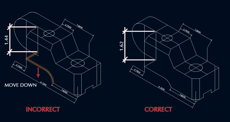

basty Posted January 28, 2018 Posted January 28, 2018 How to draw this? See the drawing of mine in attached ACAD file (it's not finish yet). Is there something wrong with my drawing? The R 0.81 make me confuse because it doesn't fit to the drawing. Vibrator Arm.dwgFetching info... Quote

basty Posted January 28, 2018 Author Posted January 28, 2018 ReMark said: It is not unusual that these types of drawing exercises have erroneous or missing information. If you say so, why my drawing result is different from the problem (see below image)? 3D generator said: Rather than drawing a 2D isometric, I'd recommend 3D modeling the part and then creating an isometric view of it. You could use the model documentation tools to set up the view. Add the annotation in paper space using associated dimensions that have the isometric settings added to them. I am practicing my 2D drawing skill, 3D modeling is a lot easier than 2D drawing. So, do anyone know where the mistake I made or the problem might slight error? Vibrator Arm.dwgFetching info... Quote
eldon Posted January 28, 2018 Posted January 28, 2018 If you look at the diagrams, it is apparent to me that the 1/2"R fillet at the bottom is tangential horizontally, but not vertically. Quote
3D generator Posted January 28, 2018 Posted January 28, 2018 I agree, 3D modeling is easier than 2D isometric drawing so why not use it? 2D isometric drawings are for software that can't handle 3D geometry. If you can 3D model it you should as it's faster and more accurate. As far as fixing the existing 2D isometric goes, it looks like the isocircle diameter at the left end of the part is too big. If you reduce it to match the intended intersection it should fix the drawing. Quote
Cad64 Posted January 28, 2018 Posted January 28, 2018 (edited) Eldon is correct. See below. I would also agree that 3D is much easier and faster, so why don't you use it to your advantage? Create the 3D model and then generate your isometric view from the model. As I always say, use the right tool for the job and work smart, not hard. Edited January 28, 2018 by Cad64 Quote
BIGAL Posted January 29, 2018 Posted January 29, 2018 Agree with Eldon and Cad64 2*.81 = 1.62, 1.94 -1.62 = 0.32 so not a full tangent hor & vert. Quote
basty Posted January 29, 2018 Author Posted January 29, 2018 (edited) eldon said: If you look at the diagrams, it is apparent to me that the 1/2"R fillet at the bottom is tangential horizontally, but not vertically. You were very observant. How did you notice that? Cad64 said: Eldon is correct. See below. I would also agree that 3D is much easier and faster, so why don't you use it to your advantage? Create the 3D model and then generate your isometric view from the model. As I always say, use the right tool for the job and work smart, not hard. Thank you guys for the clue and hint. Edited January 29, 2018 by basty Quote
BIGAL Posted January 29, 2018 Posted January 29, 2018 Quote You were very observant. How did you notice that?Your 1st image clearly shows the 1.94 dimension. See my other post. Quote
