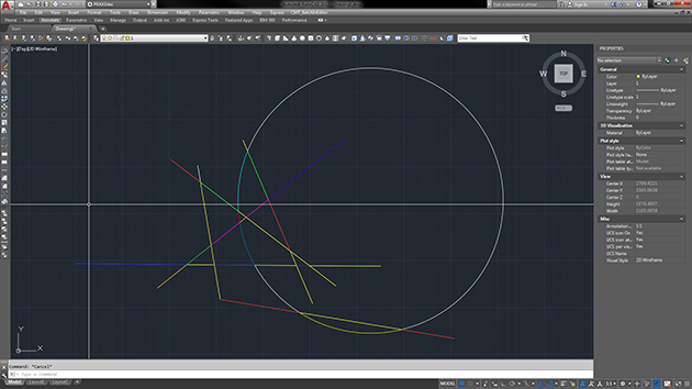

Is a Lisp possible to create lines and arcs?
Original
Line:3
Polyline:1
Circle:1
Modified
Line:31
Arc:6
I look for the way to create lines and arcs for points of intersections.
You still have not defined the task do you just want to draw lots of lines and arcs then find intersection points ? Pretty easy result will be by creation order. Still no code you must explain your request more clearly we understand sometimes a language problem in asking question. Do I understand right break into lots of little bits ? There are some here better than me at that type of task.
Sounds like you want a lisp routine that will execute a "break" at any and all intersections.
The lisp routine you are looking for was written about 9 years ago by CAB (Charles Alan Butler) and posted over at The Swamp. It was called BreakObjects.lsp and included several different break routines in one program. I may have a copy around somewhere but I'll have to look for it. There was another routine AsmiTools_Bri.lsp written by ASMI and included in a file named AsmiTools.zip. I think a copy of the file is here at CADTutor.
