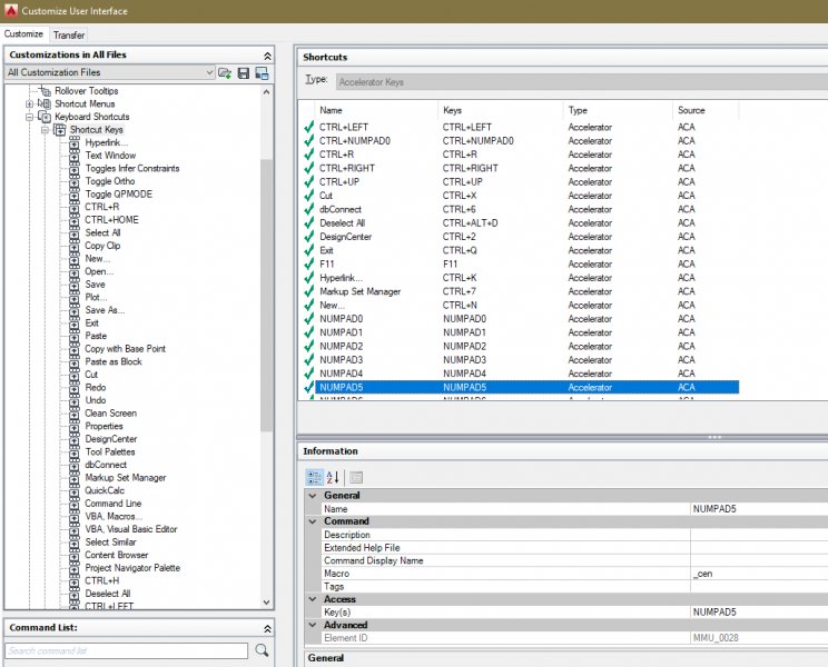

guran Posted January 22, 2018 Posted January 22, 2018 You can use Shortcut Keys as in this image. It's been many years since I did this and now I do not remember exactly how it was done, but you find out. Quote

rkent Posted January 22, 2018 Posted January 22, 2018 (edited) You could use the "F" keys, and make yourself a template. I recommend the F keys for the osnaps, I have used them for years and really like selecting them that way rather than using running osnaps for most of my work. You can edit the CUI to set the F keys for the osnaps. Open the CUI, expand the Shortcut Keys section, find the Snap, Endpoint command from the lower left list, drag and drop in the upper left section in Shortcut Keys, select that, go the the lower right section and find the Access, Key(s) line, pick once the the right of that and an ellipsis will show, pick that and hit the F key you want to use. Hint - make sure the caps lock is off. Edited January 22, 2018 by rkent Quote
