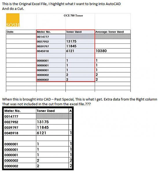

I have an excel file that I cut a range of cells and go to autocad and do a past special and it brings in more informatin then was grouped in the range of cells in excell file.???
See attached jpg fo example.
this a problem I have had with OLE of a spreadsheet. You are pasting an image of the spreadsheet. It is particularly bad if you expand the selection - the new cells don't always ge included. As you are using 2008 why don't you use a datalink - much more reliable.
Just highlight the cells you want, Ctrl + C, flip over to your cad drawing, Ctrl + V. It will insert what you've picked and a box will pop up asking you for a scale size and whatnot.
You will also be able to double-click on the cells once it's inserted and it will pull up the spreadsheet so you can edit it. Whatever changes you make will be reflected back on the drawing.
I do this every day making production tickets.
you can also use the table command and insert an autocad table and link you excell file to it.
