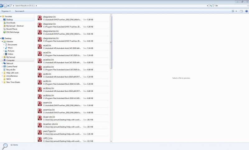

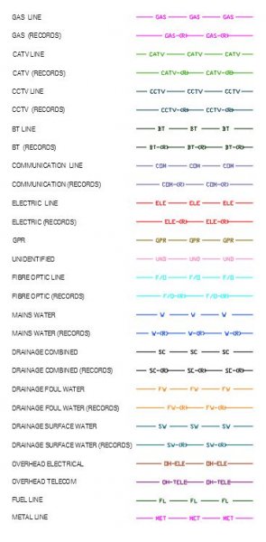

BIJI SAMUEL Posted January 17, 2018 Posted January 17, 2018 Hi every one.:)oo:) One year ago i have created a dedicated Linetype file(.lin) for my Utility Survey drawings. I have saved that .lin file in to the support folder at C:drive and last 11 months i was using that with out any issues. Unfortunately when i was at Holiday someone else was using my PC and now i cant find that .lin file any more. But in properties i can still find all linetypes and its NOT making any issues to change one normal linetype to those utility linetypes. But i simply missing that .lin File. i have search in the C: drive with *.lin. i can find many .lin files except the one i have created. Can any one help me to find that file please. Many thanks Biji Samuel Quote

BIJI SAMUEL Posted January 17, 2018 Author Posted January 17, 2018 Thanks for your reply. I have searched on C:drive *.lin And i have got 42 results, except my utility.lin file. Quote

BIJI SAMUEL Posted January 17, 2018 Author Posted January 17, 2018 Yes Re Mark, i know it was my mistake i did not keep a copy anywhere else. i has got 28 different linetypes which took me a lot of time to create. i do believe that, file is still in my Network or in my PC. Because i have no issues to use those linetypes in my drawings. only thing is that how to find out.:o Quote

BIJI SAMUEL Posted January 17, 2018 Author Posted January 17, 2018 Sorry dear i was busy. here we go... New Layers and Line Types.dwgFetching info... Quote

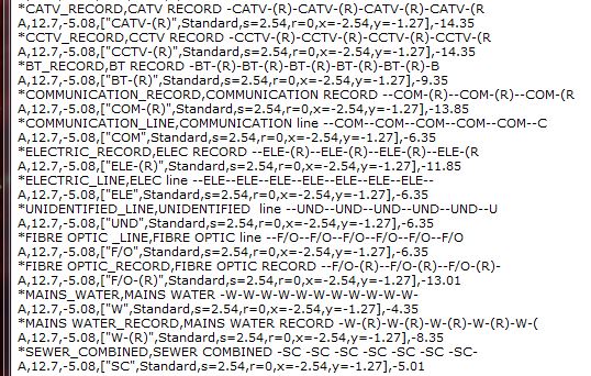

rkmcswain Posted January 17, 2018 Posted January 17, 2018 The lesson BIJI SAMUEL --- is that linetypes are not only stored in .LIN files. They are stored in any .DWG file in which they are loaded (or defined... .yes you can define a linetype without a .LIN file). Now should have Autodesk included a utility to export linetype definitions to an external file? Sure, they could do that, but they are working on more important things. So Paul Turvill did this, about 18 years ago. You can find this utility here, along with some other goodies. Oh, and it's free. Quote
ReMark Posted January 17, 2018 Posted January 17, 2018 You haven't been paying attention. No I cannot FIND the Utility.lin file BUT I can recreate all the linetype definitions saved to a file bearing the same name as the drawing they were extracted from and given the .lin file extension. This file could then be renamed to anything I like (ex. - Utility.lin). This all took less than a minute. And as I posted much earlier there are at least four different lisp routines that can do this simple task. I used the LINOUT.vlx routine I found over at the CADforums (Czech website). Quote
