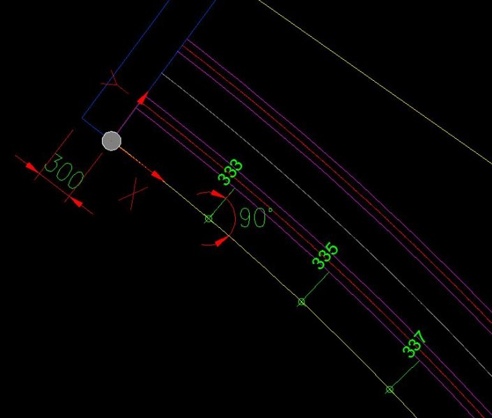

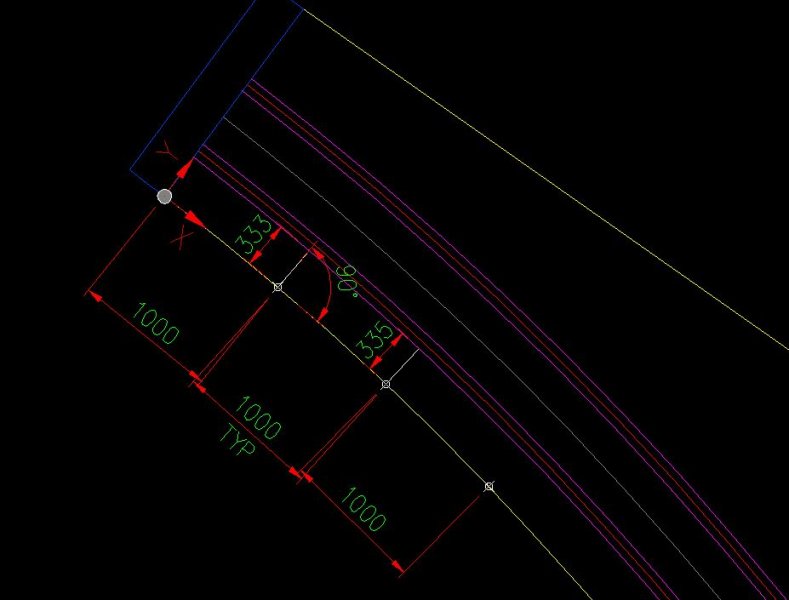

I wish to get a help from you regarding taking measurements in between two lines.
my requirements are
Generate points at 1m
generate perpendicular lines from its base location
extend till the magenta line
give line length.
can you guys help me?
Kindly see the attachment.
Thank you.
This is known in civil engineering as Peg & shift. The code is pretty straight forward, just checking something I have.
Try this it is a start. If you want it all dimensioned etc then thats a biggger task.

Edited by BIGAL
thank you so much Bigul
i wish to remain the value at end or start of line, instead of displaying in a window
no need of dimensioning.
can you modify this lisp please?
thank a lot
The code above has been updated I will leave it to you to play with the exact text location, also not it expects text style to have height set. Put a fix in for text ht as zero you may want to change the 2.5.
