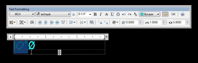

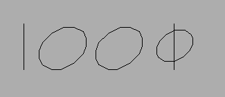

slovenc0417 Posted January 10, 2018 Share Posted January 10, 2018 Our office has been using the archquik.shx font forever. One thing that always bothered me is that when using MTEXT I cannot get a diameter symbol. I can type the symbol by pressing (ALT+0216), but the diameter symbol changes to another font, Arial in this case. If I use the the symbol option while within the 'Text Formatting' window of MTEXT, I get the symbol, but again it changes font style to ISOCPEUR. In either of the above scenarios I cannot then change the symbol to the archquik font. See the screenshots as an example. However, if i use the single line text command, I can type %%129 and get the symbol in the archquik font. Therefore, it is supported within archquik, but not when using MTEXT. Is there anyway to get MTEXT to recognize the diameter symbol in archquik? And if so, is there a shortcut keystroke that can be incorporated similar to the ALT+0216 that I mentioned earlier? Quote Link to comment Share on other sites More sharing options...

slovenc0417 Posted January 10, 2018 Author Share Posted January 10, 2018 To get a diameter sign in ARCHQUICK font, use the unicode string \U+0081 Excellent. Is there a way to include that specific code on the symbol list (third screenshot on my initial post)? Quote Link to comment Share on other sites More sharing options...
