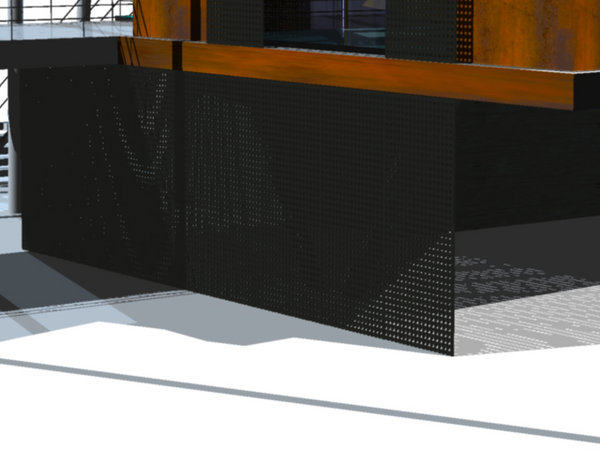

BenGoble Posted May 7, 2007 Author Posted May 7, 2007 Heres a qucik image of how I'd like to use these perforated metal sheets, but evidently the form is quite complex I'v had to cut one sheet into a third to get it under the file limit! It also slows the pc down inevitably but if Brep could cahnge that I don't know, I'll have a look in the help files. Perforated Metal Sheet.dwg Quote

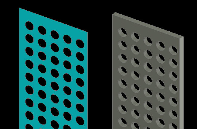

kencaz Posted September 22, 2009 Posted September 22, 2009 To expand on Matt's Layer's idea. You could use copy face to create a surface region representing the solid which would be much easier on the recsourses. KC Quote
shift1313 Posted September 22, 2009 Posted September 22, 2009 thanks for making a screen shot ken. thats just what i was thinking:) Quote
