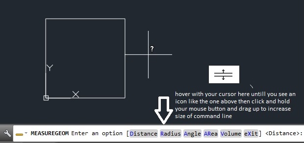

steven-g Posted January 9, 2018 Posted January 9, 2018 Unfotunately screen grab won't capture the cursor, take a look at the image which shows what the cursor should look like to expand the command line. move your cursor over the thick line at the top of the command line and it will change the curs orto a double line with arrows up and down, then just click and hold your left mouse button and drag that line upwards to expand the command line Quote
