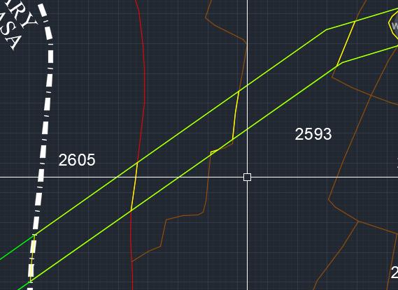

We preparing an Area report of Land Acquisition and Utilization of Survey Boundaries along the Road Project area.
First i create boundary command to which pick point acquired land in between ROW (Right of way) and then we use the area command to select polyline in Area Layer to put the manually in excel survey number and area one by one.
It takes a lot of time to make it, so there is easy way to make it lisp or any program.

You have asked the best, a solution maybe to walk along the middle of the two lines creating bpolys, and asking for placement of area. Looking at 2 line crossings.
I did though notice a tiny wedge its included so an auto bpoly may not be the answer.
Guys on the left the text of Lupung 2065 area green polygon = 785.83 same as excel easy way to find example. A cross check the total area of the two green lines must equal the area of all bpolys else you have bits missing.
Look left of 2593 this polygon crosses multiple points, but includes a tiny wedge.
I dont think this is going to be easy, thinking a bit more maybe a Cookiecutter approach.
This may border on a commercial answer.
