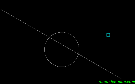

I want to re-route a lwpolyline (red line), when it crosses a circle (cyan dashed), with a specified bend radius (green line). The lwpolyline is always located in the first quadrant, but the start/end point can be in any direction. The circle CP can be either left, right or on the lwpolyline. The bend radius line has to follow the shortest route around the circle. in the end the bend radius line needs to be added to the existing lwpolyline
I have managed to calculate the 4 vertex points (v1-v4), but i have problems calculating the correct bulges, since the direction of the lwpolyline affects the order of first angle and second angle to calculate the correct bulge (positive or negative)

In routine, write and use bulges for one case... Then check for intersection of green lwpolyline and circle; if there are 3 points of intersection (use 'intersectwith method) which will always be true if bulges are opposite, you then switch bulge signs and the result should be like it was drawn in your picture... If intersectwith returns single point or equal points to apex quadrant point of circle, then sign assumptions are correct and routine should terminate without needing of switching bulge signs...
Try the following:

Come on man....This is ridiculous! Looks more like a christmas present then an answer to me :D. I will try it as soon as possible, merry christmas!
@gsc... You can avoid bulges - you just need points...

I have tested both solutions succesfully, thanx for it, but I am focussing on Lee's code:
In my example I used a straight polyline (red line) with only 2 points as an example.
But this polyline can also have multiple vertices and possible tangent arc-segments.
In fact there can be multiple circles around the route of the polyline, which need to be avoided.
This means that there may be more vertex points than only PT1 and PT2 (in between or outside)
So I also need to:
