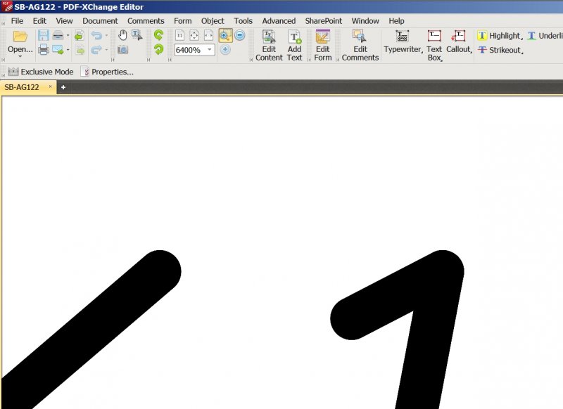

David Bethel Posted December 20, 2017 Posted December 20, 2017 Like you guys, I have tried various methods of producing higher quality pdfs. The best I have found is to plot to postscript file and then use acrobat distiller to make the final pdf. Autocad has used for as long as I can remember ( maybe release 9 ) and distiller gives you a lot of control for quailty. These are shx font text entities @6,400 ( screen saved to jpg ) I don't think it can get much smoother. I don't know if SU can deal with post script on not I do think ACAD pdf drivers does not output in the same manor -David Quote
f700es Posted December 20, 2017 Author Posted December 20, 2017 The new PDF drivers included with current versions of Acad do a good job at PDFs (for once, they used to suck). I for one try to avoid SHX fonts as they don't translate into searchable PDFs all that well, or not in my findings. Quote

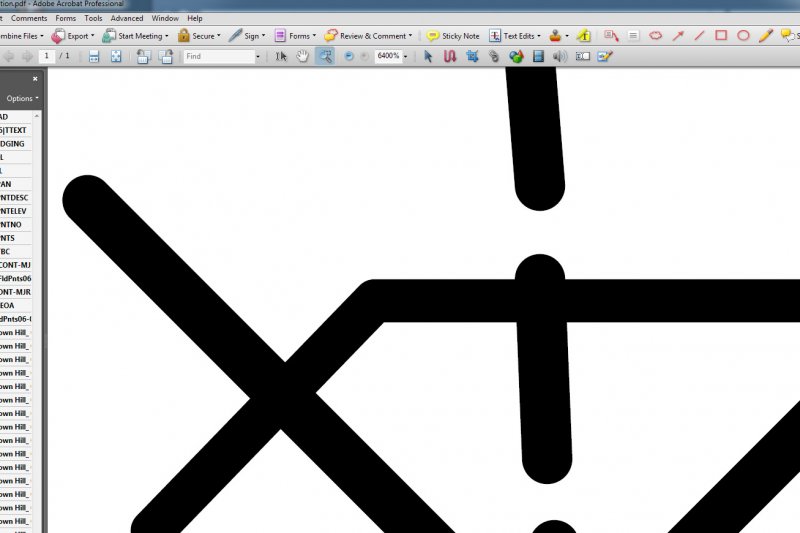

Cad64 Posted December 20, 2017 Posted December 20, 2017 Below is a pdf I just printed with the built in "DWG to PDF" printer that ships with Autocad. Zoomed up 6400% in Acrobat. No pixelation at all. Quote

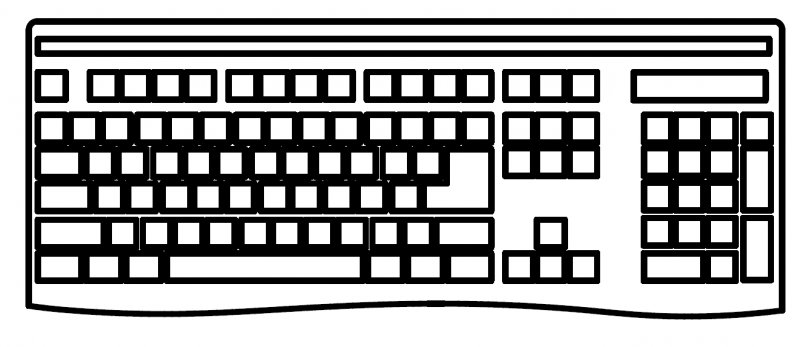

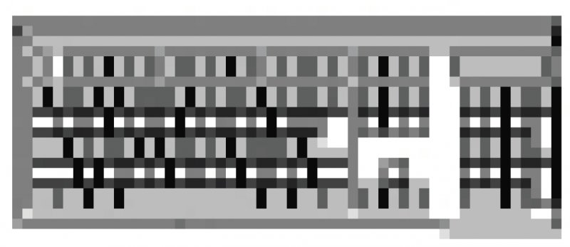

eldon Posted December 21, 2017 Posted December 21, 2017 I thought to zoom in at 6400% on a keyboard in each posted files. Guess which one is from which program. Quote
tzframpton Posted December 21, 2017 Posted December 21, 2017 Hmmm... boy. Let me think here.... LOL! Quote
