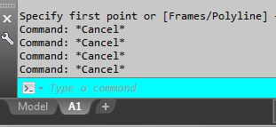

Don't know how to explain this. I'd like the COMMAND word to show up in my command line. see screenshot. Anyway to reset this?
I have 2 screenshots, one with the COMMAND and the other without.

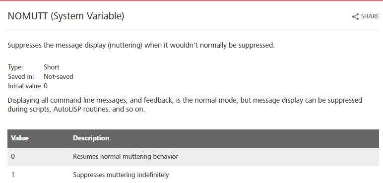

Looks like one of your coworkers was having some fun with you by resetting the system variable NOMUTT from its default of "0" to the value of "1".
Thanks ReMark, i didn't know about that NOMUTT command.
