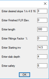

BIGAL! i have to say that it has been some time.
i wanted to run back over this post and see how things progressed. i have been using this on a constant basis and i can thank you enough!
i was trying to identify within the code the math. when you input a set of numbers, the absolute feet will show the elevation minus what was put in the starting elevation. so if it is a zero then you would end with a number in the negative.
the total overall is only showing a positive number. which in turn if i was to add the minus there mentally it is only off by .01 when the math is complete. so i am trying to identify where in the code i can add or change for this to also produce a negative number?

i see that the math portion of this lisp is with this.
(setq totlen (+  (* len  perc) len ))
; this should return the value of total length multiplied by 25%
(setq totslope (* totlen  div) )
(setq totoall (+ (+ (+ inv slabd) safety) totslope))
(setq tot  (- flr totoall))
when you have a moment to take a look at this and point me in the right direction, that would be great.

What are the values you are using ?
Flr=0 then tot should be negative ?
Expand
Attached are screen shots of what is being used. for myself i see the process of this. so if you are to use a factor of 100' for your finished floor, the factors that are getting returned (in a screen shot) of 94.83 absolute feet. which one can simply look at the table and see that is 5'-2.0" below 100'. some of the advantageous snowflakes, cant see that simple math.
so i thought that i would see if it would be possible to be able to do this? something that i just thought about that might also work if it is possible. what about adding to the lisp to have this return in a MText to the side the math calculation? i have been searching around trying to find something that you would be able to add this to, but i am not able to find anything.
but both of these are nothing major, just more of a question.  personally this works just fine for myself. but thought that i would ask the question

What you can do is add to the dcl say the Total o/all and the Absolute as an answer. I have a DCL that has 3 inputs and uses combo of sliders or values entered but shows total below will have a think about it. It will mean the dcl is no longer a library function but hard coded into the code.
