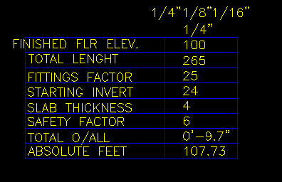

MINOR edits to a lisp? please help
Ok I set it all up and thought it was working and then wondered why values were wrong, when you create the block it is very important to create the attributes in some form of order, when you use the (command "insert" it fills in the block attributes in order not matching tag names. You can insert a block supply defaults then change via tag names but this adds a lot more code to a simple task. The other way is to leave as is and change the "Insert" order.
I rehacked the block and recreated the attributes only got 1 out of order and just used the option in bedit to fix.
; simple example of filling in a block attributes with calcs
; by Alan H Dec 2017
(defun c:pipe-calc ( / len ans div slabd inv safety tot totslope oldatt )
(if (not AH:getval7) (load "getvals1-8")(princ "loaded"))
(setq oldatt (getvar 'attdia))
(setvar 'attdia 0)
(ah:getval7 "Enter desired slope 1/x 4 8 16" 5 4  "4" "Enter Finished FLR Elev. " 5 4  "100" "Enter length " 5 4 "50"  "Enter Fittings Factor  %" 5 4 "25" "Enter Starting inv " 5 4 "24" "Enter slab depth" 5 4 "4" "Enter safety " 5 4 "6" )
(setq div (/ (/ 1.0 (atof val1)) 12.0 ))
(setq flr (atof val2))
(setq len (atof val3))
(setq perc (/ (atof val4) 100.0))
(setq inv (/ (atof val5) 12.0))
(setq slabd (/ (atof val6) 12.0))
(setq safety (/ (atof val7) 12.0))
(setq totlen (+  (* len  perc) len ))
; this should return the value of total length multiplied by 25%
(setq totslope (* totlen  div) )
(setq totoall (+ (+ (+ inv slabd) safety) totslope))
(setq tot  (- flr totoall))
; this should return a value in decimal format for the finished floor elevation - total overall slope. example would be 5' 5-1/2" - 100' = 94.542
(command "-insert" "PIPE-CALC" (getpoint) 1 1 0   (strcat "1/" val1 "\"") val2 val3 val4 val5 val6 val7  (rtos (* totoall 12.0) 3 1)  (rtos tot  2 2))
(setvar 'attdia oldatt)
(c:pipe-calc)

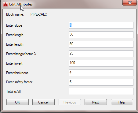

ok so I downloaded the block that you updated and when I insert it, it is giving me the option to add the values that I am looking for. however it is leaving the last two (total length for architectural and absolute feet in decimals) blank. so I thought that was a little weird that it was asking for that information.
I also copied the lisp that you updated and when I load that, at first it didn't want to load. I was getting an error msg again. I am able to go thru "appload" and it will state that it is "successful" and then once I hit ok, it errors out.
when i was able to get the lisp to finally load one time, the dialog box popped up as "edit atributes" to enter the values and there is an additional ""enter length" i think that was just a typo so i went in and change up a few thing on that to get the wording to make sense.
but i am still not able to get the lisp to load and i don't know why. i must be the most unlucky sucker on the internet. i am wondering if i need to give up on all of this lol
I will check it needs Attdia 0 for it to work may have left that off, also realised the 1/4" refers to drop per 1 foot so I need to correct the maths also.
I see that attdia 0 is on line 8. Buy I also see this at line 26:
(Setvar 'attdia oldatt)

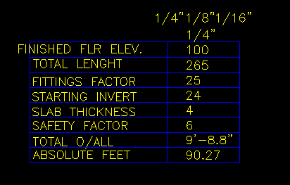

Updated code and I think it all correct now I work metric so had to have a think about feet units, that was what was screwing my testing up. Its doing my head in not getting the correct numbers just post here the correct values as a column of numbers then I can see where my maths is wrong.
Here is the math that I use when doing this the long hand way: (sorry trying to put this in the code selected window isnt working right for me right now.)
SLOPE VALUE = 1/8INCH (1/4" OR 1/8" OR 1/16")
TOTAL LENGTH = 265FT
FITTINGS FACTOR = 25%
STARTING INVERT = 24INCHES
SLAB THICKNESS = 4INCHES
SAFTY FACTOR = 6INCHES
THE LONG MATH LOOKS LIKE THIS:
(265 * 25% = 66.25 +(ORIGINAL LENGTH) 265FT = 331.25FT)
(331.25FT / 1/8INCH = 41.40625 (COULD BE 1/4” 1/8” 1/16”)(MIGHT NEED TO CONVERT FROM FRACTION TO DECIMAL TO MAKE THE MATH EASIER 1/4 = .25 - 1/8 = .125 – 1/16 = .062)SHOULD ONLY NEED TO HAVE 2 DECIMAL POINTS - 41.40)
(24INCHES + 4 INCHES + 6INCHES = 34INCHES)(41.41INCHES + 34INCHES = 75.41) (CONVERT TO ARCHITECTURAL FT AND INCHES 6’ – 3.41”)))
(6.29FT – 100’(100’ IS THE FINISHED FLOOR ELEAVTION) = 93.7FT)
CONVERSION MATH:
6FT – 3-1/2 IN = 6.29 FT
6 FT GETS MOVED SO WE HAVE 6
NOW WE CONVERT THE INCHES TO FT
3 + (1/2IN) = 3.5IN
NOW WE CAN CONVERT THAT INTO FT BY DIVIDING IT BY 12 AS 12IN =1FT
3.5 / 12 = 0.29166666666’
AND NOW LETS CONVERT IT TO 2 DECIMAL POINTS
0.29166666666 = 0.29’
I have updated the code again, now I know why I love metric. As I dont work in feet just had to find the correct inch/foot values.
I have reloaded pipe-block again also.

wow the calc works great!!!
i am having some issues with the block though. attached pictures show when i insert it and after running the calc. i open the PIPE-BLOCK.DWG file and i have made the changes that i wanted to. (i.e. adjusting the text locations) and hit the save button. when i close out the drawing, and then insert the same DWG i was just in the block is back to the way that it was. i am not understanding what is happening?
when i try and purge things out it is stating that there are nested items and i can purge them. is there something that i am missing?
